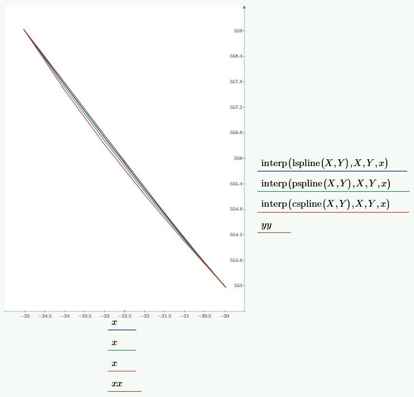

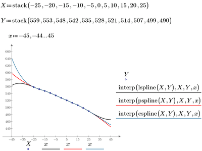

There is a fourth spline possibility. Call it a dspline? A spline can be put through n points in the XY plane if you also specify the derivatives or slope at each end point of the spline. I used to do this with roller coasters so the curved track could match slope of straight portions at start/finish. Using this method no extrapolation is possible.
The four splines looking closely at first two points. Each is subtly different.
As "terryhendicott" points out, each option provides the flexibility to more closely fit a cubic spline representation to the function/response you may need to model, because of the end-point conditions. I've used 2 variations in the past to mimic the behavior of a system that requires each of those two conditions at their endpoints. It is very useful to have these options available to us.

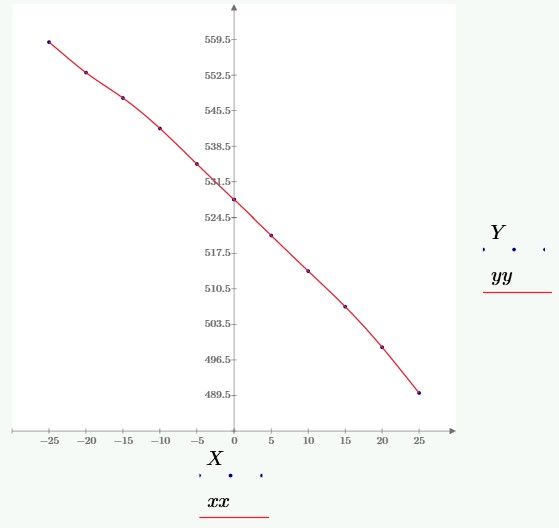

Two picture from the chapter 15 Hydropower "Thoughts and Calculations when Looking at a Banknote or Spline Interpolation" of the book
STEM Problems with Mathcad and Python - 1st Edition - Valery Ochkov - (routledge.com)
