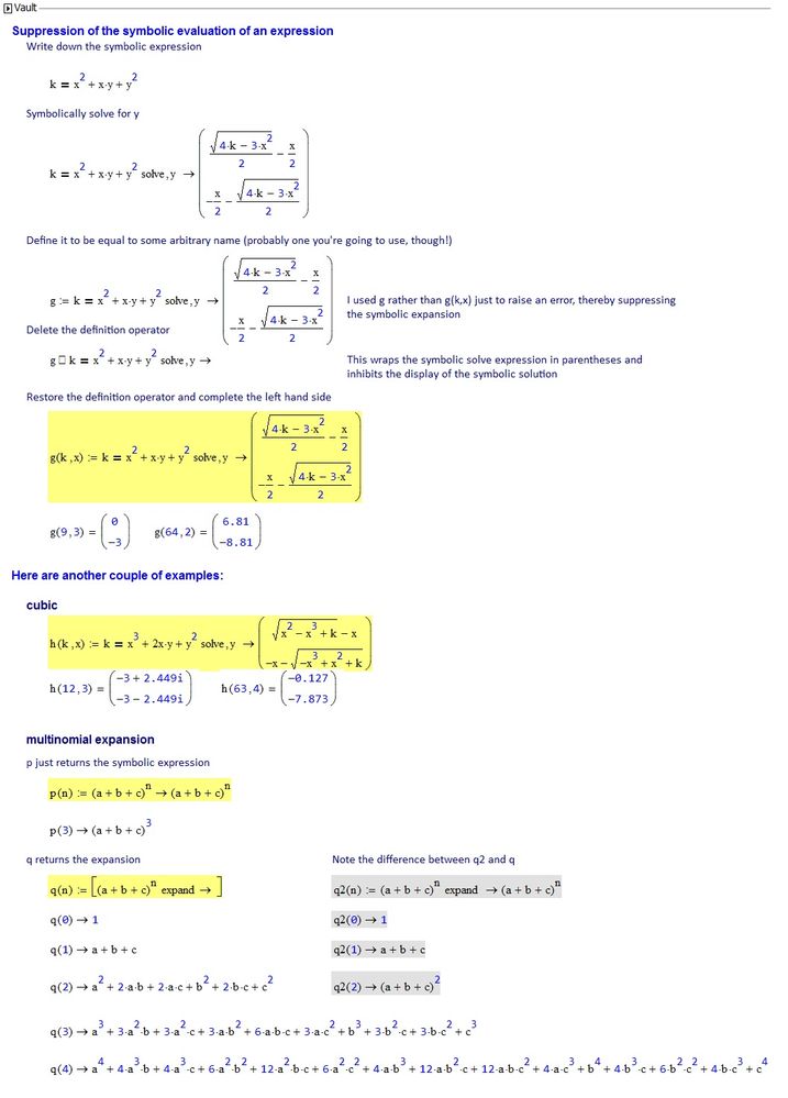

I don't know if this has been noted before, but I managed (by accident) to suppress the display of a symbolic solve in M15 [Mathcad 15.0 (M030 [MC15_M030_20131216])]
Does this work in other versions of Mathcad?
Stuart

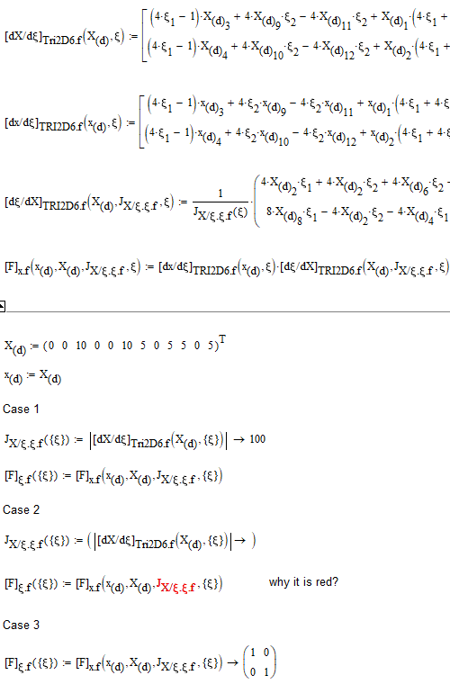

ifomenko
(To:-MFra-)
I hope I understand your trick but it doesn`t work in my case and I don`t understand why.
File is attached
