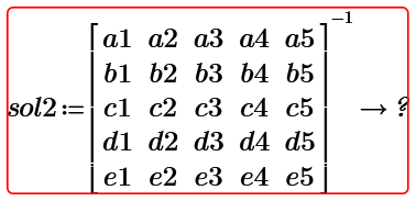

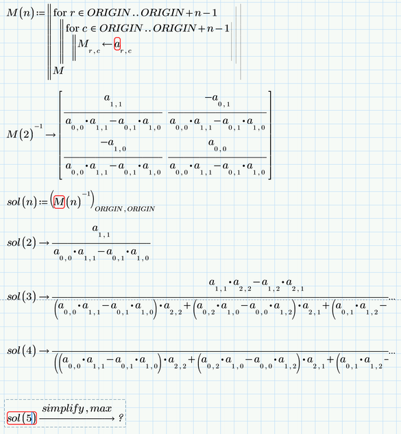

I think that I reached the full capability of Mathcad Prime 8 regarding the symbolic calculation. Or I am wrong?
Can somebody run this sol2 determinant in Mathcad Prime 9 to see the result?
Mathcad Prime 8 file attached.

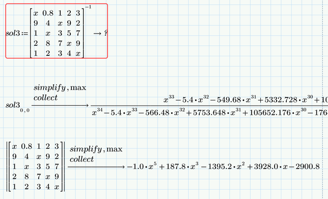

Here is what I see in Prime 9 when I recalculate your sheet.
As you can see the result for the determinant is much nicer, the one for the inverse seems to be as ugly than what you got in P8.
Using 0.8 forces the symbolics in some sort of numeric/floating point mode (unfortunately).
If possible its always worth a try to change float numbers to fractions with integers.
You may use the "float" modifier yourself if appropriate
Experimenting with the number of significant digits in "float" can give unexpected results
Not sure where the factors 1.0 stem from. Most of them go away if we omit the "collect" modifier - strange!

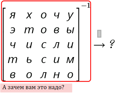

My Mathcad
Cornel
(To:ValeryOchkov)
Uh, I do not understand Russian language, but I think it is the same result that my above result, right? And your Mathcad is Mathcad Prime 9?

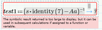

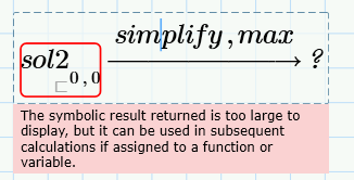

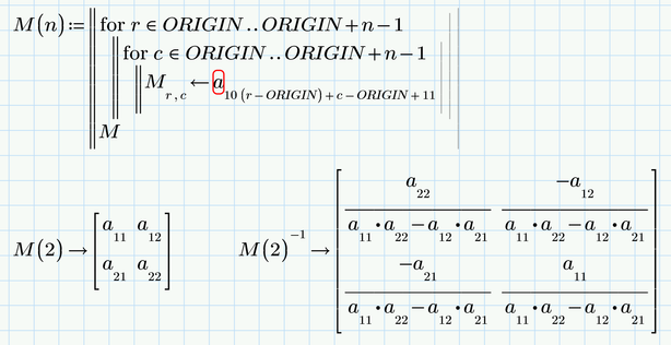

Very same effect in Prime 9, too.
Prime allows to display the numerator of the first element, but the denominator is too large in the opinion of Prime.
Actually its not a limitation of the symbolics itself as you get a result which you could assign a function (with 25 arguments) which then could be used for further calculations.
Its just an artificial display limitation as the developers thought that it would not make much sense to see an expression that huge and decided to save the memory which would otherwise needed for displaying the result.

For me its not a problem which needs a solution.
If its a problem for you, you may contact PTC support and open a support case. Tell them why its a problem and talk them into modifying Prime so that larger results could be displayed  on screen (maybe like it could be done in Mathcad 11 by using a registry entry).
As I see it you have four options
  1. Wait for Prime to be modified accordingly (I won't hold my breath)
  2. Get somehow access to an older version of Mathcad (version 11) and use it
  3. Use a different program with more capable symbolic and display options (not sure if Maple, Mathematica, MatLab, ... could fulfill your needs)
  4. Think about what the benefit of seeing such huge expressions displayed on screen actually would be and maybe come to the conclusion, that its not worth bothering anyway ;-).

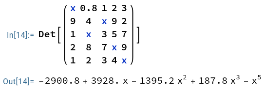

Yes, I know that, but here the problem is how to calculate symbolically the DETERMINANT and INVERSE of the matrix, not how to calculate numerically the DETERMINANT and numerically INVERSE of a matrix.
For example, look:
Result of the determinat with Wolfram Mathematica:
Result of the inverse of that matrix with Wolfram Mathematica:
Do you see the differences? The results of the two (determinant and inverse of matrix) from the two software are not displayed the same.
My question here: is it possible to see also in Mathcad Prime the same results of the determinant and inverse as it is shown in Wolfram Mathematica?
These results in Mathcad Prime with those great powers in calculation of the determinant (x^17 at numerator and x^12 at denominator) and inverse of matrix (x^33 at numerator and x^34 at denominator) seems strange...and I do not know why it looks like this and why Mathcad Prime gives the results in this manner.

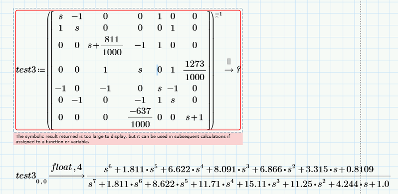

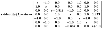

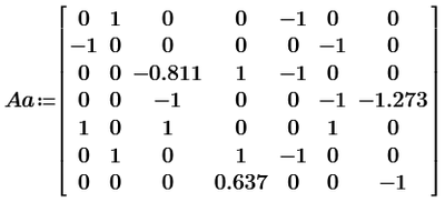

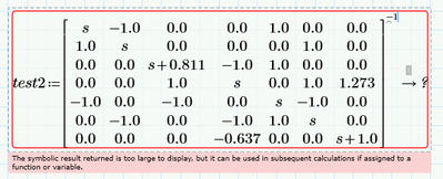

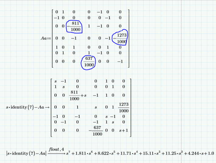

Here I have another example from one of my past post:
Determinat of s*identity(7)-Aa matrix:
Not Good
Good
Inverse of s*identity(7)-Aa matrix:
Not Good
Not Good
Good
So, it is seems so far that the "problem" at Mathcad Prime is that he (Mathcad Prime) doesn't like calculation with decimal numbers...
Is there any method by which to convert Mathcad decimal numbers into fractional numbers automatically?
Or the only option here in this case is to look at each number in the matrix and manually change each number from decimal to fractional?

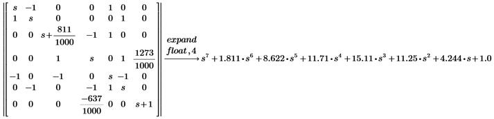

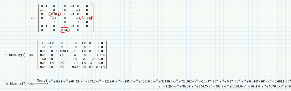

Look:
-0.811, -1.273 and 0.637 change further in the s*identity(7)-Aa matrix also the other values from the resulted matrix from integer numbers into decimal/float numbers (for example: 1 into 1.0 and 0 into 0.0 -> 1 and 0 are the only non-decimal numbers in Aa matrix, if there were other values the same thing would have happened).
And now if we change in Aa matrix from the beginning -0.811 into -811/1000, -1.273 into -1273/1000 and  0.637 into 637/1000 then the result of determinant is changing also, and also the values of 1 and 0 in resulted  s*identity(7)-Aa matrix does not change into 1.0 and 0.0:
(To:Cornel)
Its not clear to me what you want to show with this.
Using exact integer fractions gives an exact result, even though "float" is used, while using decimals results in floating point results which cannot be simplified, maybe because of inaccurate intermediate floating point results.
That was the reason why I suggested that you may try using exact fractions to get simpler results.

The symbolic output of Mathcad (and Prime is no different) is hard to control. With some tricks, this matrix:
Has a determinant of:
And its inverse is:
Cornel
(To:LucMeekes)
Hi Luc, What do you mean more exactly  by "with some tricks..."? Because in the images you show you didn't apply any trick...Or?
LucMeekes
(To:Cornel)
Just one trick.
The 0.8 is not a number, but a variable. It is defined as:
0.8 := 8/10
But essentially that's al there is to it.
