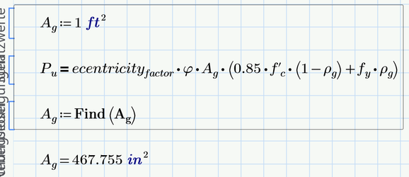

I am trying to fetch the required gross concrete cross sectional area of an RCC column using the SYMBOLIC Solver function as shown below. But I could not figure out what is causing this abnormal output. Could someone kindly clarify this issue? I would be much obliged.

After using the Units/constants in symbolics under 'Calculation options', the last unit appeared as shown here though it was supposed to show in only Area unit (sq.m. ,sq.in., etc.). This is where I am stuck, what could be the solution to this particular confusion?

So if you only want a numerical value, you should consider using a numerical solution method. Prime offers the solve block with “Find” for this purpose, as well as the “root” function, which can be used in two different ways.
Here is one way to use the “root” function by providing an interval (here 0 in^2 to 20 ft^2)
And here the "root" function by providing a guess value first:
And here a solve block with "find"
A solve block does not seem to be the first choice here, but it has advantages if you want to add additional conditions or solve a system with multiple equations and unknowns.
Prime 10 worksheet attached
