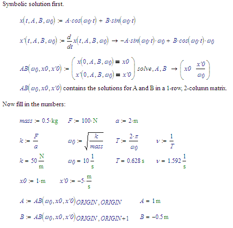

(To:Sergey)
Lucs symbolic solution in his Prime worksheet does not work for two reasons:
.) Prime does not like the capital "S" in solve
.) Primes auto labelling once again ruined the job. Some of the variable names A, B are labelled differently. If all are labelled the same ("auto" OR "variable") the symbolic solution works OK
In case you wonder why Luc is posting a non-working version: He is using Prime Express and so has not access to advanced features like symbolics, programming, etc. So he has to do the work "blindfolded" which he is able to do because of his huge experience with older (and better) Mathcad versions.

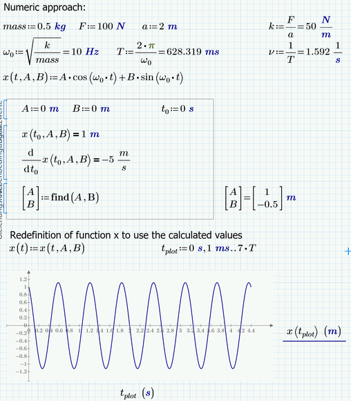

Find attached a Prime 4 worksheet with the working symbolic solution and a slightly different numeric approach using just one single solve block:

(To:Sergey)
You posted just a picture!
You may get rid of the argument omega_0 when defining functions x
you can delete the first and third of your constraints in the solve block as they aren't doing anything
I wont use the temporary variable "constants" but rather replace it with a vector [A,B] as seen in my sheet.
To avoid typos or other errors I'd prefer to define x(t) after the solve block using the original function rather than retyping the function term. Its also seen in my sheet how this works.

Sergey
You have to delete the fourth argument omega in ALL occurrences of x(...)
I have put the definition of t:=0s back inside the solve block as that way after the solve block t still is a free variable. It does not matter, though, as you redefine t as range variable anyway.
AS an alternative you might get rid of t:=0s altogether and use constraints like x(0s,A,B)=1 m, etc. in your solve block. Matter of personal taste I guess.
Worksheet in P4 format attached.
