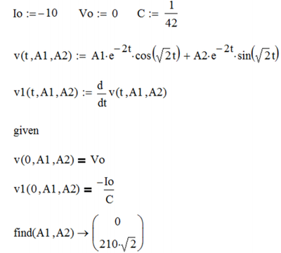

I am a user of (real) Mathcad for a long time and now shifted to Mathcad Prime 7.0 and have started learning it. I am facing a problem in using symbolic evaluation in solve blocks using Mathcad Prime. It was a bit easy in (real) Mathcad but now I don't know what's the problem and why prime is not showing the answer.
The problem statement in (real) Mathcad is

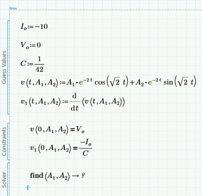

But when I use the same steps to solve the problem in Mathcad Prime it is showing a question mark with no hint of where the problem occurs.
Please guide me, what am I missing or it is some incapability of prime that (real) Mathcad has for years.

You are missing the fact that, in contrast to real Mathcad, Prime does NOT support solving solve block symbolically.

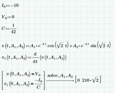

You should set up your solve by solving the set of simultaneous equations symbolically. Create a vector containing the two expressions, and solve that symbolically.
Something like:

Symbolic evaluation in solve blocks is not supported in Mathcad Prime, but you can do the following to get the same result.
May I ask an unrelated question? You did not use literal subscripts in Mathcad 15, but used them in Prime document. Why? Any specific reason?
No @MSheykman  there is no specific reason. I was doing the problem in Mathcad prime, and when I was not able to figure out why the answer was not showing, quickly developed a (real) Mathcad sheet to know what am I missing. It was developed in a hurry and that's the only reason for not using literal subscripts.
