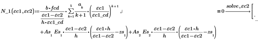

Dear PTC Mathcad Community,
I want to ask for clarification on the behaviour of units and symbolic substitution in Mathcad Prime (similar topics have already been raised, but I still haven't found an appropriate answer for my issue).
 So I try to find a symbolic expression for epsilon_c2, which is a parameter of the equation N.
Solver succeeded with the issue, but with incompatible units (see picture)
So, I have tried to find out the solution in the community, but the advice of @Werner_E  with calculation options didn't resolve the issue (see the picture)
So my issues are:
1. How to make the symbolic solving more "seamless" with appropriate units' manipulation in the solutions?
2. Why does Mathcad not see the assigned values of the  epsilon_c2 obtained in the previous solution?
After some time, when the file has been refreshed, some magic happened, and now I can use the roots of epsilon c1 and c2 in a "normal" manner.
But the next issue is that it doesn't let me substitute the obtained symbolic solution into the following step calculation for the moment M calculation.
As it can be seen, the factual equation is real, with proper units,
Nevertheless, Mathcad is still not satisfied with...

LucMeekes
(To:Ivan_Pat)
The best way of using the symbolic solver is to use it with symbols only. That is:
- Do NOT use units.
- Do NOT use floating point numbers ( integers are OK, instead of 0.5 use 1/2, instead of 1.414... use √2 ).
It means that any variables you use in the symbolics are not assigned a (numeric) value.
To obtain numerical results, you best assign the result of the symbolics to a function of all required variables and call that function with the numeric values, including their units.
So instead of:
do:
Oh, and in case you are not interested in the symbolic solution, and you just want a numeric solution, then use a numeric solver (solve block, root() function or other suitable numeric function) instead of a symbolic one.

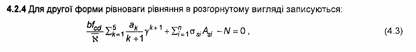

You have set out to produce a reinforced concrete section moment-curvature diagram.
Want to help you but things vary from country to country.
Going back to your last post you have the polynomial coefficients for the shape of the concrete stress-strain block.
Can you show me a plot of the stress-strain block using these polynomial coefficients and values of relevant strain points as this is one of the things that vary between countries.
The problem can be solved without symbolics but using parametrized solve blocks, and root functions.
Can you describe what the symbol gamma, and squiggly N are in equations 4.2.4?  Draw a diagram.

Hi Terry!
The squiggly N  is the Hebrew character Alef.
Alef (א) in equation (4.3)  is the curvature of the beam and is equal to א = (ec1-ec2)/h
Gamma (γ) is the (ec1/ec1_cd) which does not contain ec2.
Can you make a sample of your own on how to use parametrised solve blocks and root functions?
Looking forward to hearing from you.

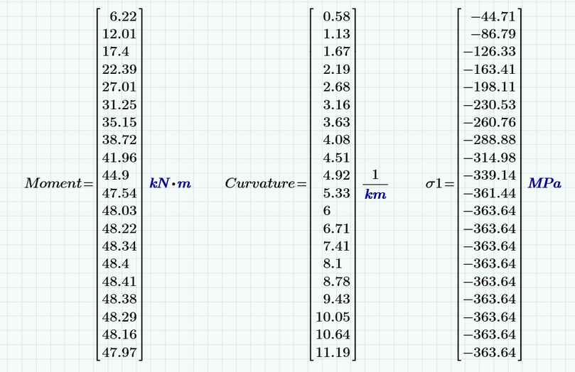

By the way, I got the result in my file.
The script works as it should.
Ready for the routine programming.

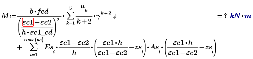

(To:Ivan_Pat)
I have no experience whatsoever in your field of work and can't comment on concrete behaviour, moment curvature, etc. but I don't see a system of two equations in your extensive explanations so far.
What I had seen so far are the assignments of functions N and M (it seems to should be a function) and it looks like both should be dependent on ec1 and ec2:
and
The definition of M seems to be erroneous (unit mismatch).
Now you have the equation
but i don't see the second equation, which may
Once you actually have two equations you could try to solve them symbolically for ec1 and ec2 (not sure if Prime is capable enough to do so) or you could use a solve block to do so. In case there are more solutions, a solve block would only give you one of them. Which one you will get depends on the guess values you provide.

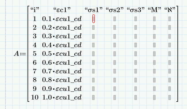

Ivan_Pat
(To:Werner_E)
@Werner_E Hi Werner!
Thank you for your interest in the problem and for your help with the issue.
You figured out the mistake in the units of the M equation. The proper equation for N (4.3) and M  (4.4) should be as follows:
In general we'll have such an  M(ec1, ec2) equation:
As you correctly noticed, two functions should be treated simultaneously, one after the other, in the following way:

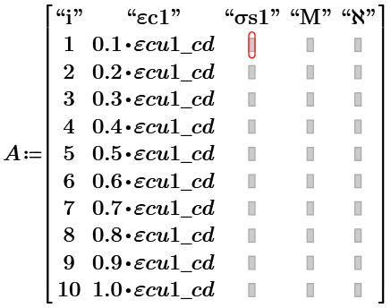

1. On the first step, we start to solve the governing equation, where N=0 by substitution on the first step the ec1=0.1*ecu1,cd (where ecu1,cd - ultimate strain value of each grade of concrete, is known) and ec2=0.02*ec1,cd, by controlling the stress value in reinforcement σs (that should not be greater, than fyd - limit design stress of the reinforcement).
If the ec2 of governing equation is bigger than that, which leads to stress fydi in the reinforcement Asi, we assume that root (ec2) of the equilibrium equation (4.3)  as the solution and reassign it to the equilibrium equation 4.4 for moment (M):
The obtained value for the moment will be the first point of the state diagram "Moment-curvature".
The cycle will continue until we reach ec1=ecu1cd.

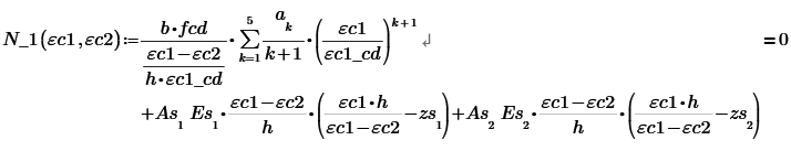

Ivan_Pat
(To:Werner_E)
@Werner_E Yes, you are right. I messed up the definition of the equation and the assignment here. As well, you are also right in the assumption that moment M in Equation (4.4) is the function of ec1 and ec2, where ec2 is a calculable argument from Equation (4.3) and ec1 is the iterable of ecu1_cd (known limit strain of concrete grade, which we put in the Equation (4.3) for the fitrst time ec1=0.1*ecu_1cd, for the second ec1= 0.2*ecu1_cd, and so on until ec1=ecu1_cd.
On each iteration of ec1, the ec2 is to be found. From Equation (4.3) under condition (fyd) and substituted afterwards into Equation (4.4) to find the i-th moment M value of the state diagram "Moment-curvature".
The moment is to be calculated after the ec2 led to zero in equation (4.3)
You are partially correct in:
@Werner_E wrote:
When I look at the equations 4.3 and 4.4 I miss the variables ec1 and ec2 which you concentrate on.
It looks to me that these variables are hidden in א and also in gamma?
The goal is to find ec2 from Equation (4.3) under the condition of fyd and to substitute it into Equation (4.4)  where the moment M is to be calculated.
Equation (4.3) with double layers of reinforcement (As1 and As2)  will be as follows.
We have to solve it with respect to ec2, subject to the condition:
Where fydi= yield strength of i=th reinforcement layer. If ec2 found in Equation (4.3) exceeds the ec2 that led to the left side of the expression Ivan_Pat_2-1766246835938.png to be bigger than fyd, then we need to use that  value to substitute into Equation (4.4) to find the factual moment M according to
And so on until we finish the iteration cycle with ec1 = ecu1_cd.

You would have to use a solve block instead of the "root" function to be able to add additional constraints.
Are you sure that there is a solution for ec2 for every ec1 given that three additional constraints? As far as I had seen in the sheet I posted, the solution was unique even without any additional constraints...
Or are you trying to increase ec1 until you find a solution which fulfills all three constraints?
As I understand it, M has nothing to do with finding appropriate values for ec1 and ec2.
You may consider posting your sheet containing the corrected definition of M and also the constraints you were talking about.

💪Almost excellent! I got the follows:
The two questions to experts arose:
1. How to modify the graph with ec1_0=0, in other words, how can I do the plot starting from the beginning of the coordinates?
2. By having the data in matrices like
How can I obtain a more "seamless" view of the matrix like
I'll be very grateful for any assistance in this regard!
Prime 10.0.0.0 is attached.
(To:Ivan_Pat)
With ec1=0 your calculations will result in a division by zero.
So what should be the values for all the variables in your table when ec1=0 ?
You will to have to add them atop (using stack) manually after calculating all the other values or you consider the case ec1=0 via if-statements in your program to avoid the division by zero. In the latter case you could use
at the start of your program, but with the calculations given you would end up with a division by zero error.
Otherwise see my comments and modifications highlighted in red in the attached Prime 10 sheet.
