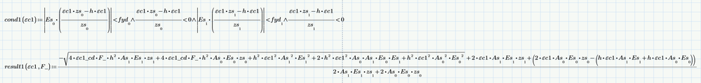

Dear PTC Mathcad Community,
I want to ask for clarification on the behaviour of units and symbolic substitution in Mathcad Prime (similar topics have already been raised, but I still haven't found an appropriate answer for my issue).
 So I try to find a symbolic expression for epsilon_c2, which is a parameter of the equation N.
Solver succeeded with the issue, but with incompatible units (see picture)
So, I have tried to find out the solution in the community, but the advice of @Werner_E  with calculation options didn't resolve the issue (see the picture)
So my issues are:
1. How to make the symbolic solving more "seamless" with appropriate units' manipulation in the solutions?
2. Why does Mathcad not see the assigned values of the  epsilon_c2 obtained in the previous solution?

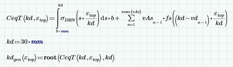

Version 4 of the file.  Have found a couple of issues on checking my work.  First to answer your questions.
"h" is not used in my worksheet.  d is indeed h-as.  the depth from top compression fiber to bottom steel layer.
The curvature is derived from e/kd not (ec1-ec2)/h.  It is the same result.
Calculations for ecu1_cd/2 are an example only, I used as a check.  they could be taken out and the sheet would still work.

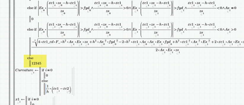

(To:Ivan_Pat)
i <- 0 is a local assignment!
In a conditional you have to use the comparison equal (Boolean equal)
See modifications in attached sheet.
If you just wanted all values to be zero in front it would have been easier to work from the previous sheet and simple add the zero values on top 😉
According your comments in the sheet - I don't see what you seemed to have seen. I only see errors because ec2 is not defined, etc.
You changed ORIGIN from 1 to it default value 0.
When you had a sum running from 1 to rows(...) it will not work that way, because vector indexing start with 0 now.
You are better of letting the sum run from ORIGIN to last(...). That way you are independent from the setting of ORIGIN.

(To:Werner_E)
To make clear what I meant with my remark
"If you just wanted all values to be zero in front it would have been easier to work from the previous sheet and simple add the zero values on top"
You simply have to replace the bottom line of the program
with
to get
and
ORIGIN was not changed, its still 1..
I also noticed that the variables sigma_s1_2 and also x1 which you calculate are never used !?? So these calculations
and
could be deleted.

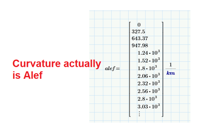

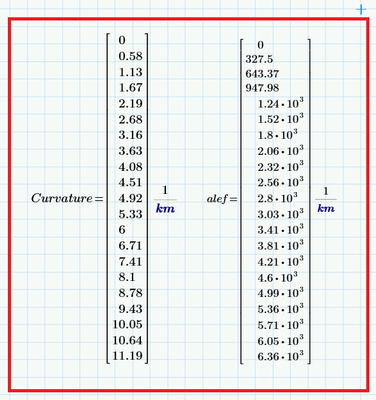

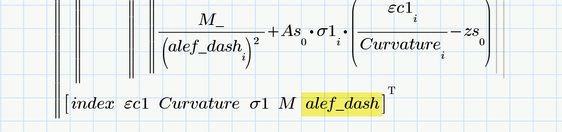

I still can't catch where the term "alef" is assigned from?? I have found no such assignment in the code, but I understand it is assigned elsewhere... Why is it important? Because I need to analyse the dependence (Moment Curvature = alef). And the point that alef is not the Curvature in terms of values.
Prime 10.0.0.0 file attached.
(To:Ivan_Pat)
"alef" is on of the return values of your large iteration program. Its the last of the six returned results
And the values in "alef" correspond to the vector of values which you called "alef_dash" in your program.
As I have no experience whatsoever in your field of work I can't say if or why it may be important or what the meaning of those values would be. Its one of the vectors of values you calculated in your program, so I returned it so you can examine them in the sheet. If they have no importance, simply remove this return value.
Note that a program in Prime cannot alter variables defined in the worksheet nor can your worksheet look at the variables calculated in a program. If you need values which were calculated in the program you have to explicitly return them as the result of your program. To return more than one value you have to put them in a vector or matrix.
To return something from a program you may use the explicit "return" statement. Otherwise the result of the last line executed  is the returned value. That's the reason why I did not need touse "return" in the last line.
But you sure can use
it may be good style anyway.

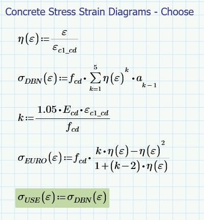

Hi
Version 6 of calculations now allows for choice of DBN or Eurocode stress block.
All the sample/checking calculations are removed leaving the bare bones.
Calculation of kd using the root() function is essentially the solution of a quadratic so a negative value is possible (especially at low curvature) the guess value could lead to the negative solution.  Negative value of kd messes up the moment curvature graph at low curvature.  The workaround is to use a better guess for kd at half the maximum steel depth instead of 30 mm.  Graph glitches go away.

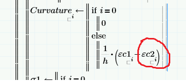

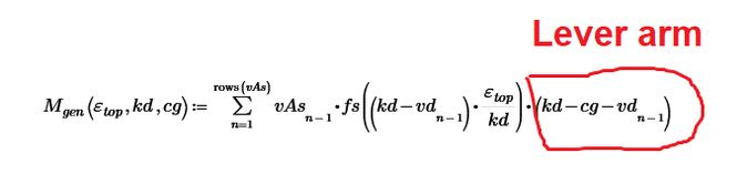

I tried a little bit to analyse your Moment equation. Thus, according to the analysis of equation (4.4)
We do need to consider the moment of equivalent concrete centroid (first member of the equation), or by your assignment:
Since it affects the total M value, it creates a moment that is taken with the lever arm cg (according to your assignment) against the clockwise direction. M=Centroid*cg
In my case it has a significant influence on the total moment M
I take the curvature as the maximum of design depth vd1, which'll be constant and not depend on the first assumption of kd=30 mm, as in your sample.
As I see from your moment calculation, you ignore the centroid input to the total moment M. You use only the moment produced by reinforcement multiplied by the respective lever arms. Why?
Also, I didn't catch why you don't put ec1u_cd as the maximum compressed strain of concrete instead of etop?
File attached.

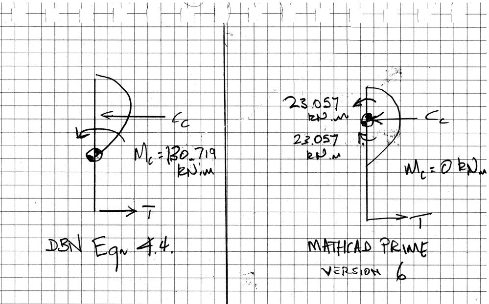

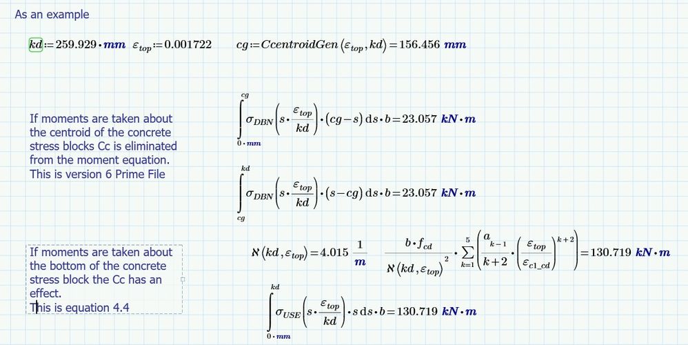

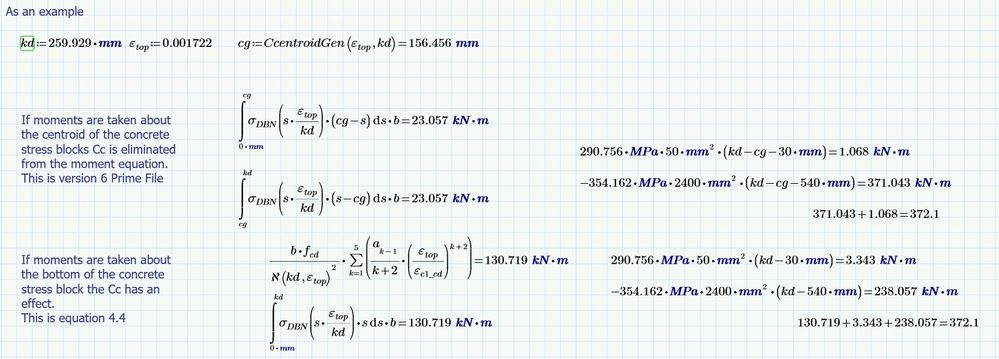

The trick is in where to take moments about for the moment equilibrium calculation.
Version 6 takes moments in the section about the centroid of the concrete section.
Equation 4.4 takes moments about the bottom of the concrete stress block.
Here is a diagram and calculations of the difference.

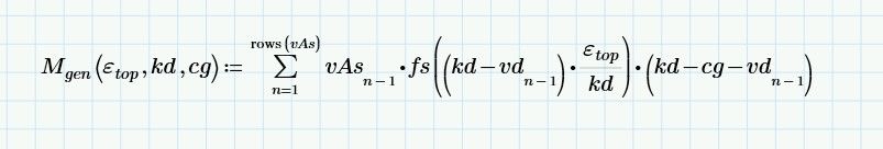

@terryhendicott Hi Terry!
Thank you for your explanation, but I'm still concerned about the correctness of my interpretation of your file and logic embedded in v.6/
 I don't want to be annoying, but it seems to me that you misunderstand equation 4.4.
In my graph, you can see how the logic of equation 4.4 is built ( probably you've got it earlier, but still I want to express it by picture, maybe here is the point of your misunderstanding)

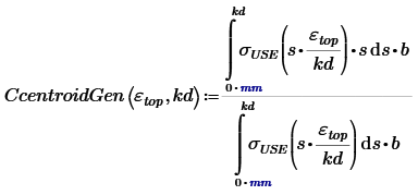

It does not matter if you take moments about the moment centroid of the compressive stress block, or moments about the bottom of the concrete stress block you get the same answer for section moment.
When using the centroid of the concrete stress block as point to take moments about, lever arm of the tensile reinforcement is longer and gets the same overall moment.
When using the bottom of the concrete stress block as point to take moments about, lever arm of the tensile reinforcement is shorter and gets the same overall moment.
Here is sample calculation of both:
Cheers
Terry
Thanks for the clarity.
You are definitely right regarding the leverarms - if we do take the moment of compressed concrete with its arm Fc*concrete arm, the respective arm of the reinforcement will be shorter, and the total moment M in such a case will consist of two components  - concrete and reinforcement.
Otherwise, if we get an appropriate value of lever arm of compressed concrete block from the root() function, we can calculate the total moment M as the reinforcement equivalent force Fs multiplied by the bigger lever arm = (lever arm of concrete+lever arm of reinforcement)  without considering the impact of compressed concrete Fc*concrete arm in the total moment M.
As far as I messed a little bit with your symbols, you do calculate the moment M under the second, bigger lever,  arm without considering the impact of compressed concrete Fc*concrete arm. Am I right?
As far as I messed a little bit with your symbols, you do calculate the moment under the second, bigger lever,  arm without considering the impact of compressed concrete Fc*concrete arm. Am I right?
Yes
Cheers
Terry

Your solution is really elegant. The only question that arose in my head: Does it consider multiple reinforcement layers? As far as I can assume, it does.

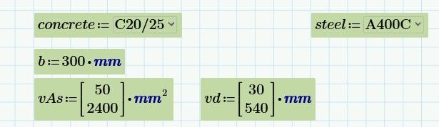

Yes just add as many rows as you need to vectors "vAs" and "vd".  Program self adjusts to the size of these vectors.
The only fixed thing is the calculation of reinforcement stresses that only considers two layers.

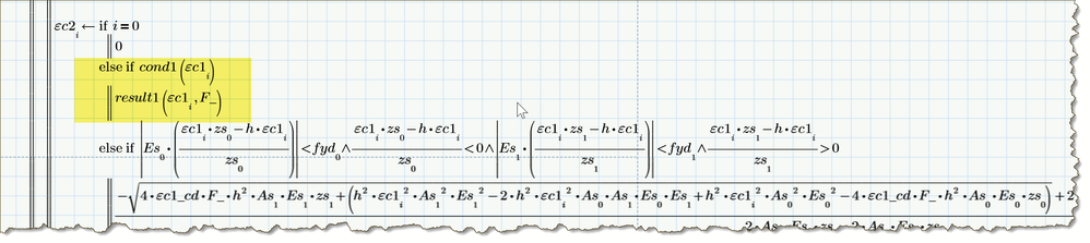

I tried to modify the original file a little, adding extra reinforcement (a total of three), each with different characteristics (e.g., A240C, A400C, B500).
But my plot is not represented, due to the syntax errors (probably)
I also liked observing how each reinforcement stress is changed along the ec1 axis. It means that I want to draw the fyd of each reinforcement and to fix the range where the stress is above/below this line. The idea of drawing the horizontal line  in the form of a transparent matrix [] T was taken from @Werner_E file,
but also without results.
Can you look at what is incorrect in my attempt, please?
I'll be very grateful for any assistance with my question.
PS All my modifications are highlighted in yellow.
Prime 11.0.0.0 file is attached.
Happy New Year to you as well.
Comments in red where I have made alterations to get it to work.

Changed the diagram of reinforcement stress-strain.  Replace strain at the top of section with strains at the level of each reinforcement.
Cheers
Terry
