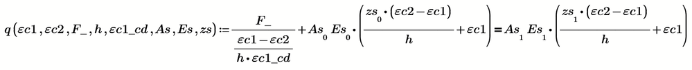

Dear PTC Mathcad Community,
I want to ask for clarification on the behaviour of units and symbolic substitution in Mathcad Prime (similar topics have already been raised, but I still haven't found an appropriate answer for my issue).

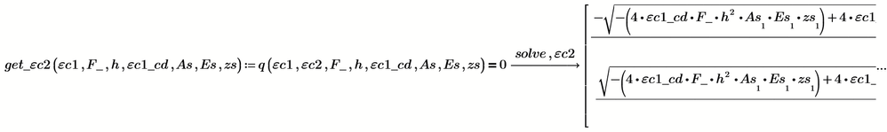

 So I try to find a symbolic expression for epsilon_c2, which is a parameter of the equation N.
Solver succeeded with the issue, but with incompatible units (see picture)
So, I have tried to find out the solution in the community, but the advice of @Werner_E  with calculation options didn't resolve the issue (see the picture)
So my issues are:
1. How to make the symbolic solving more "seamless" with appropriate units' manipulation in the solutions?
2. Why does Mathcad not see the assigned values of the  epsilon_c2 obtained in the previous solution?

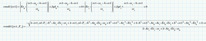

After some time, when the file has been refreshed, some magic happened, and now I can use the roots of epsilon c1 and c2 in a "normal" manner.
But the next issue is that it doesn't let me substitute the obtained symbolic solution into the following step calculation for the moment M calculation.
As it can be seen, the factual equation is real, with proper units,
Nevertheless, Mathcad is still not satisfied with...

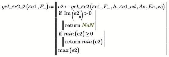

(To:Ivan_Pat)
"alef" is on of the return values of your large iteration program. Its the last of the six returned results
And the values in "alef" correspond to the vector of values which you called "alef_dash" in your program.
As I have no experience whatsoever in your field of work I can't say if or why it may be important or what the meaning of those values would be. Its one of the vectors of values you calculated in your program, so I returned it so you can examine them in the sheet. If they have no importance, simply remove this return value.
Note that a program in Prime cannot alter variables defined in the worksheet nor can your worksheet look at the variables calculated in a program. If you need values which were calculated in the program you have to explicitly return them as the result of your program. To return more than one value you have to put them in a vector or matrix.
To return something from a program you may use the explicit "return" statement. Otherwise the result of the last line executed  is the returned value. That's the reason why I did not need touse "return" in the last line.
But you sure can use
it may be good style anyway.

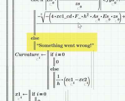

Maybe I don't understand the logic of MathCAD, but why in one case (Case of one-layer reinforcement), where I assigned the Curvature value by
Everything was seamless.
But unfortunately, after hard work with several mistakes corrected and thorough input, the same Curvature value for double reinforcement caused an error in MathCAD...
I'm on the edge of being broken.
With my "coarse" understanding of MathCAD logic, it seems to be the unexplainable issues, for me at least.
Sorry for annoying you, but I'm really trying to understand where there are possible **bleep**ups and to fix my issue.
File attached
(To:Ivan_Pat)
Your program is impossible to read for me and i was hardly able to play around with it because Prime gets unacceptably slow in reaction.
I tried to throw in a try-on_error statement at the position of the error to see when the error occurs and would return "i" and the vector "ec2" in case of an error.
It showed me that the error occurs when i=3, but my attempt to show the returned vector ec2 failed because Prime would crash.
I saw the error "Unknown error: The method or operation is not implemented" without any clue as to which 'operation or method" the message would refer to.
I looked closer (not too close as of the prohibiting large expressions) at the definition of ec2 and noticed, that you don't return a value in case none of the conditions in your many if, elseif statements is met.
So I added an "else" at the end which guarantees that ec2_i would get a value in any case.
This at least makes the program work but chances are you get some wrong values because of the arbitrary value 12345 used. This means that you should recheck the logic of the calculation - there seems to be at least one case which you did not consider correctly.
And, as I already wrote in a prior reply, your if, if else,... calculations should always return a value. This usually may be achieved by using a simple "else" as the last statement. This is where you land if none of the other conditions are met.

P.S.: You really should try to shorten the expressions and the program. Maybe its possible to split the calculations or define functions for some of them which then could use in your program.
A simple example:
Instead of
you could define functions for the condition as well as for the resulting value
and use them in your program
If you then use meaningful function names that perhaps correspond to your application, this will not only make your program easier to read, but also easier and faster to edit.

BTW, your error handling
does not work. If something went wrong you store a text string in ec2 and then you still use ec2 in subsequent calculations which will throw an error because ec2 is not a number.
You may try to use NaN instead and see if it works.
The program runs OK if you delete the implicit multiplication between Re and (, but you have to decide if using just the real part of a non-real solution gives you a correct result.

One way to avoid the copy and paste of the symbolic solutions you calculated is to turn these calculations into functions.
It does not make much sense that you define
because what you actually define that way is the resulting 2x1 vector to the very right which contains a lot of variables but sure not ec2.
I understand that you tried to document that the expression you use for solving is q(...).
You could do it that way:
First define q as a function of all variables involved (as none of them is already defined at this stage.
Then solve this function for ec2 and assign the result (which is a vector with all values for ec2) to a function whose name should be something with ecs (and some name part which distinct this from all the other functions which also would calculate ec2).
Later you could use this function providing all variables and evaluate it numerically and then examine the vector you get and chose the solution according to rules you have to provide (e.g. take the smallest if both are positive, use the largest if one is negative, return NaN if both are non-real.
I don't know if if makes sense in your workflow but after you defines the variables in front of your program to calculate ec2, only ec1 and F_ seem to be left unknown as F_ is calculated in the program.
You could as example define a new function now
This function calculates the two values for ec2 and selects one following the logic outlined above. I have no idea if that's the logic you need, though.
You can now use this function in your program instead of the huge expression you copied there.
The function I mentioned can be found in the attached file.
I did not use it in the program because I had no idea where 😉
When you use it you sure have to use ec2 with index i of course.

I want to choose only the minimal real root, otherwise to assign, let it be ec2=0.
I understand that you want to use zero if all values are non-real.
Do you also want to use the minimum of all real values if it is positive? Or do you rather want to use 0 in this case?
Why does MathCAD deliberately add an imaginary part to the real root? It seems more complicated than I can imagine.
That's the way the "min" function works:
If the elements are complex, min returns the smallest real part of any value plus i times the smallest imaginary part of any value
See the help: Maxima and Minima of an Array
