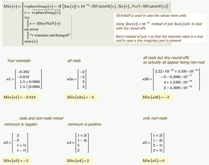

@Thank you for the clarification and the script modification, Werner.
I modified your script a little to include ORIGIN :0 in the hope that it'll give me zero values on the first iteration step, like here.
by providing a conditional statement and counting a coefficient from zero to four:
But somehow MathCAD do see the error still:

i <- 0 is a local assignment!
In a conditional you have to use the comparison equal (Boolean equal)
See modifications in attached sheet.
If you just wanted all values to be zero in front it would have been easier to work from the previous sheet and simple add the zero values on top 😉
According your comments in the sheet - I don't see what you seemed to have seen. I only see errors because ec2 is not defined, etc.
You changed ORIGIN from 1 to it default value 0.
When you had a sum running from 1 to rows(...) it will not work that way, because vector indexing start with 0 now.
You are better of letting the sum run from ORIGIN to last(...). That way you are independent from the setting of ORIGIN.

Your program is impossible to read for me and i was hardly able to play around with it because Prime gets unacceptably slow in reaction.
I tried to throw in a try-on_error statement at the position of the error to see when the error occurs and would return "i" and the vector "ec2" in case of an error.
It showed me that the error occurs when i=3, but my attempt to show the returned vector ec2 failed because Prime would crash.
I saw the error "Unknown error: The method or operation is not implemented" without any clue as to which 'operation or method" the message would refer to.
I looked closer (not too close as of the prohibiting large expressions) at the definition of ec2 and noticed, that you don't return a value in case none of the conditions in your many if, elseif statements is met.
So I added an "else" at the end which guarantees that ec2_i would get a value in any case.
This at least makes the program work but chances are you get some wrong values because of the arbitrary value 12345 used. This means that you should recheck the logic of the calculation - there seems to be at least one case which you did not consider correctly.

I have an idea to check whether each condition is a real number using my function by defining the minRealRoot function (see the picture), but, to be frank, I'm only on my way to it (((, cause even on this simple sample I do not understand how the condition is to be formulated correctly...
I want to choose only the minimal real root, otherwise to assign, let it be ec2=0.

@Werner_E wrote:I want to choose only the minimal real root, otherwise to assign, let it be ec2=0.
I understand that you want to use zero if all values are non-real.
Do you also want to use the minimum of all real values if it is positive?
I want to assign ec2 the minimum root value if the root is a real number, otherwise ec2 will be zero.

OK, so the minimum could be positive as well.
Here is a special "Min" function which should do the job.
First all non-reals are replaced by NaN's.
Then we try to delete these NaN's using "filterNaN". This functions fails if either no NaN was found or if all values are NaN's. In this case the vector remains unchanged.
Fortunately "min" returns a zero if the vectors contains only NaN's which is exactly what you want to see if all values are non-real.
Prime 10 sheet attached
