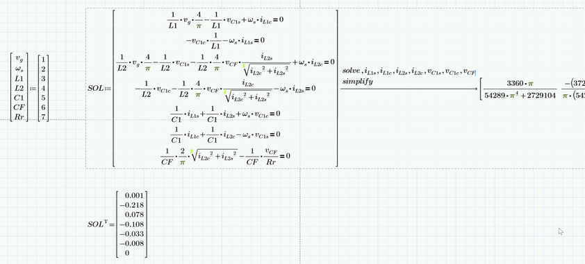

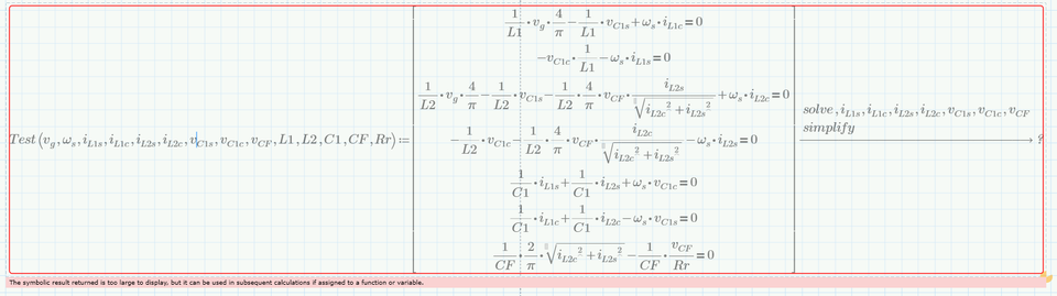

System of Equations Mathcad Prime 7 - result returned is too large to display
Cornel
Thank you.

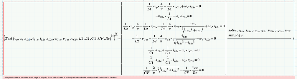

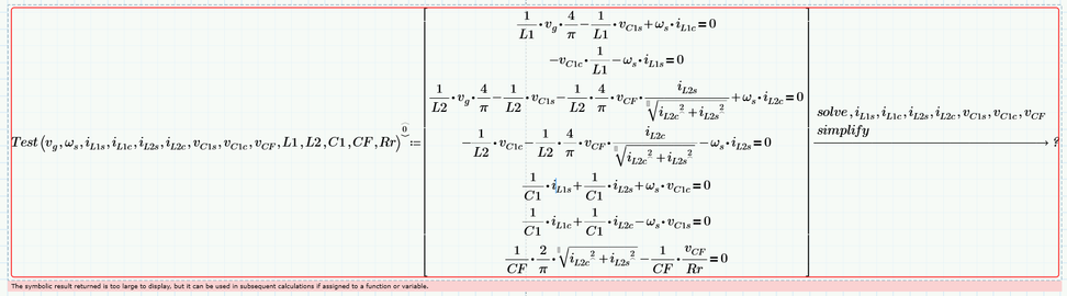

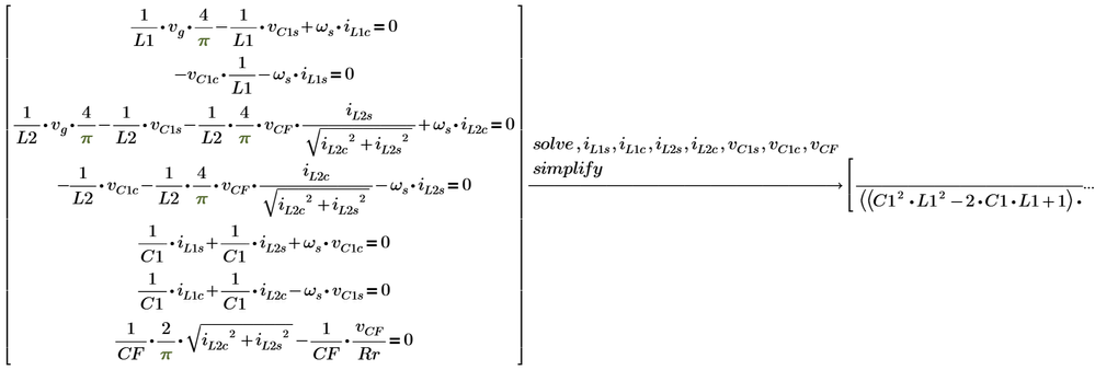

Mathcad Prime 7 file attached.
(To:Cornel)

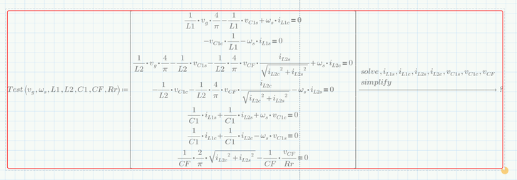

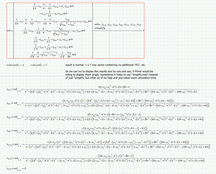

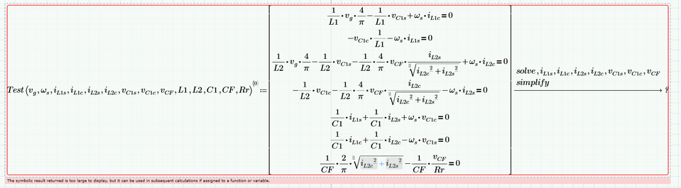

The seven variables you are solving for should not be arguments of the function and you should not use any row or column selectors.
It should look that way
and while you still would get the message that the results can't be displayed, you should be able to use the function numerically like
Unfortunately for reasons unknown to me the calculations seems to run endless and so this seems not to work.
But there are good news. While the full 1x7 result row vector is (in the opinion of Prime) to large to be displayed, the results can displayed one by one:

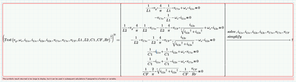

EDIT: Actually I have no idea what the problem with evaluation Test(1,2,3,4,5,6,7) would be.
After all, Prime can quickly and easily find a solution that way:
35 REPLIES 35

If you can fix omega_s then Mathcad return the answer.
So, maybe you need one more equation to solve.
Cornel
(To:ttokoro)
So, for now ws need to be defined as symbolical variable. I have 7 unknown variables (iL1s, iL1c, iL2s, iL2c, vC1s, vC1c, vCF) and also 7 equations, therefore should not be a problem with this thing...I mean in such a way that we need to assign for ws (or other variable) a (starting) value or to add more equation(s).
For example, Mathcad 11 can solve this system of equations as it is...without any problem.
(To:Cornel)
Given the error message Prime is also able to solve the system - it just refuses to display the result. MC11 could be modified so that it also shows very large symbolic results, but later Mathcad version and also Prime can not be modified that way.
You may follow the advice and assign the result a variable, or better, a function in omega.s, C1, L1, etc. which you then can use for further calculations.

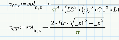

Something seems to be a little strange..

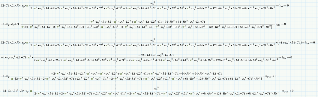

I compared the results from Mathcad Prime 7 with the results from Mathcad 11...and i saw that the resulting expression for vCF is wrong in Mathcad Prime 7, or at least I do not understand at this moment why I get vCF = 0 in Mathcad Prime 7
So, the in front expression of each -iL1s, -iL1c, -iL2s, -iL2c, -vC1s, -vC1c, -vCF are the resulted expressions obtained with Mathcad 11 and iL1s, iL1c, iL2s, iL2c, vC1s, vC1c, vCF are the expressions obtained with Mathcad Prime 7 (of course, from the same system of equations, nothing changed)
I will check once more the resulted equations from Mathcad 11 when I get home, and I will compare them again with those resulted from Mathcad Prime 7, for any...but...

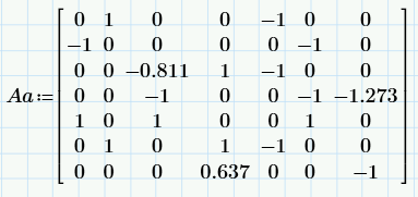

(To:Cornel)

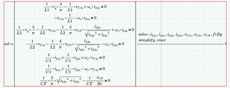

The reason for this is that your seven equations are not independent. So the system has an infinite number of solutions. At least thats what Primes symbolics thinks (i have not verified it).
Primes symbolics choses zero for one of the variables (the last one stated) and then solves the remaining system.
You can use "solve,....,fully" to tell the symbolics that you wan to see all solutions.
As you can see in the following screenshot, the solution for the last variable contains _z and _z1 which means that you can use any number for them. I don't know why Prime does not simplify these two to just one arbitrary value even though I use "simplify, max". The other solutions seems to NOT contain any _z or z_1 which means that they are always the same.
As I see it it means that v.CF can be set to any positive multiple of Rr.
I cannot say if Prime is right in assuming that the equations are dependent and if you still have access to Mathcad 11 I would rather trust the old Maple symbolic engine rather than the new one in Prime 😉
I was loading your sheet in Prime 6 and I just tried to switch to the legacy engine (muPad). But the sheet is still calculation while I am typing this. If it finishes in a decent time, I'll edit and report what the results are, but it looks like I will have to cancel the calculation after a while.
EDIT: The result with muPad is not a simple matrix, but an expression with a condition (if). So it can't be evaluated singly. So even though we can't see what muPad comes up with, it looks like it also thinks that the system does not have a single solution!
EDIT2: If, after solving the system, you let solve the last equation for v.CF you get what looks similar to the MC11 solution, I guess.  BTW, I mad a mistake in the sheet I posted as for sol[0,2 I used i.L2c instead of i.2s

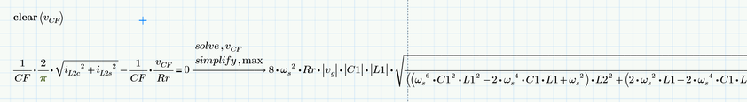

@Werner_E wrote:
"EDIT: The result with muPad is not a simple matrix, but an expression with a condition (if). So it can't be evaluated singly."
But is it somehow possible to reach the expression of vCF in Mathcad Prime 7 as it looks like in Mathcad 11?
The idea îs that I need to know all the above expressions (so it also includes vCF) both in symbolic form and later in numerical form, and in principle in Mathcad Prime (Mathcad 11 will not always be at my hand)..
EDIT: ok @Werner_E  I saw your EDIT2. I will check, and I will come back with an answer.

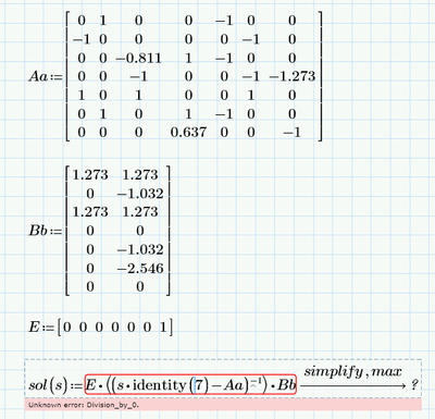

(To:Cornel)
So it looks that you have reached the limits of the symbolic engine in Prime.
Have to tried to delete the "simplify,max" from where you define sol(s) and use it when you try to evaluate the first element of sol(s)?
I can't try as all your new calculations seem to run "endless" and i have to cancel them without seeing a result or an error.
Cornel
(To:Werner_E)
 (for a few minutes he thinks, thinks and thinks). And I think that here, at this calculation, Mathcad Prime will run "endless"...
And for this, same:

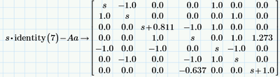

(To:Cornel)

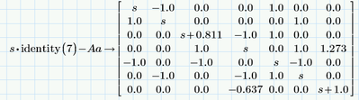

So the problem seems already to be the "unknown error, Division by 0".
Again you could report it to PTC, but I doubt that this will be of much help.

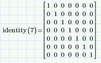

Is Prime able to calculate the determinant of (s*identity(7)-Aa ? You could then try to use Prime to manually calculate the inverse and maybe you see, where the problem with a division by 0 could be.
Again I could only suggest using a different software package to deal with your problem or to find another way to arrive at the final goal, whatever it may be. I can't think of any "workaround" here.
Cornel
(To:Werner_E)
(To:Cornel)

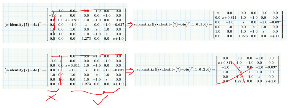

Good, so if you really want you could try to manually calculate the elements of the inverse matrix yourself step by step. Sure quite some work to do, though, and unsure if it would be worth the effort at the end.
Cornel
(To:Werner_E)

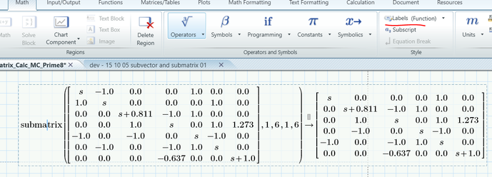

Do you know any function to extract the submatrix from the matrix that works in Mathcad Prime?
It's ok, I find:
Mathcad Prime 8 file attached.
(To:Cornel)
I don't understand. The built-in function "submatrix" seems to work OK anyway, as you picture shows.
EDIT: AH, I see now that you had written that you found it yourself.
Cornel
(To:Werner_E)
https://www.wikihow.com/Find-the-Inverse-of-a-3x3-Matrix
https://www.superprof.co.uk/resources/academic/maths/linear-algebra/determinants/minor-and-cofactor.html
How the calculation of minors can be done in Mathcad Prime, with some functions, so I don't have to do it manually?

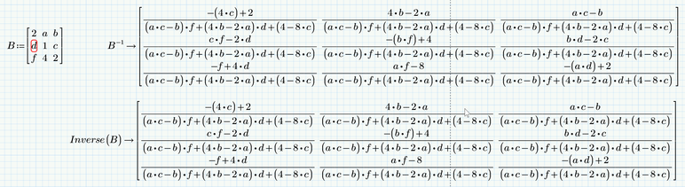

(To:Cornel)

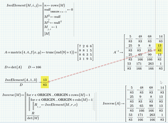

Maybe the attached sheet can be of help
You can calculate single elements of the inverse and also the whole inverse. I don't use smaller submatrices but I simply replace all values in the appropriate row and column by zeros and then set the element to 1.
No error checking implemented (matrix must be square and non-singular).
To get the minors you would have to calculate up to 4 submatrices and then augment and stack them and you will have to consider the special cases first and last row as well as first and last column where you only have to deal with two or even with just one submatrix. I found it easer to do it as described as the determinant is the same anyway.

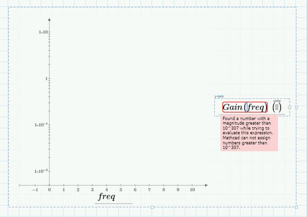

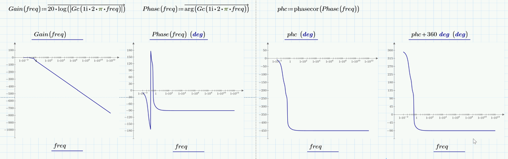

(To:Werner_E)

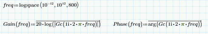

Firstly:
Can the expression of Gc(s) be simplified somehow by dividing the denominator and the numerator by s^30 for example? (in order to be easier for the next step (plotting the bode plot of Gc))
(To:Cornel)
dividing by s^30 wont help as you would run into the very same problems. Dividing by s^15 seems to be OK for this example.
And you should also change the scaling in your plots. At the time being your abscissa is scaled linear and the ordinate is scaled logarithmic - it should be the other way round:
But IMHO for quite a long time we are moving far too much away from the initial question in this thread.
There is the still open problem with the inverse and now even another one about the Bode plot.
Opening new treads for new questions would be preferred.

According the inverse: Mathematicas result isn't looking that large. On the other hand - Mathematica is only showing five significant digits while Primes symbolics per default shows 20 which would take much more space. Not sure if using the modifier "float, 5" would help Prime to display the result. Drawback is that this not only affects the display of the result but also the accuracy of the whole calculation.
My method of calculating the inverse in my sheet may not be exactly what you found on the internet. Lets use your example.
Instead of transposing the matrix and deleting the second row and first column in the transposed matrix, I don't transpose but instead set the first ROW and second COLUMN to zero with the exception of the common element.
You would have to change the sign of your result -20 because you have to multiply by (-1)^(i+j) and this is not necessary with the way I had chosen. And setting different values in the original matrix is much easier to implement in Prime than deleting rows and columns.
For the bode plot I did the very same you did (with the exception of using s^15 instead of s^30). And of course you have to assign nominator and denom to separate functions of s, lets say (Z(s) and N(s). Then you define Gc(s):=Z(s)/N(s) and thats it.
