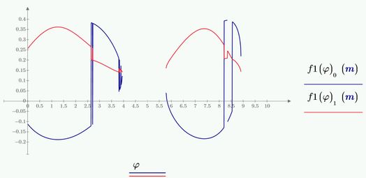

i have a problem with mathcad (Mathcad Prime 3.1): No solution was found, try changing the guess value or the value of TOL or CTOL
Can please somebody check it out, and tell me what i need to fix?
Thanks!

The error is thrown if just a single value in the range phi does not yield a result.
As you can see there is a range (approx. 4 .. 5.6) of phi values where the solve block fails.

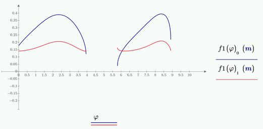

BTW, I changed the guess values for xD and yD to 0.4m and the results seems to be more consistent:

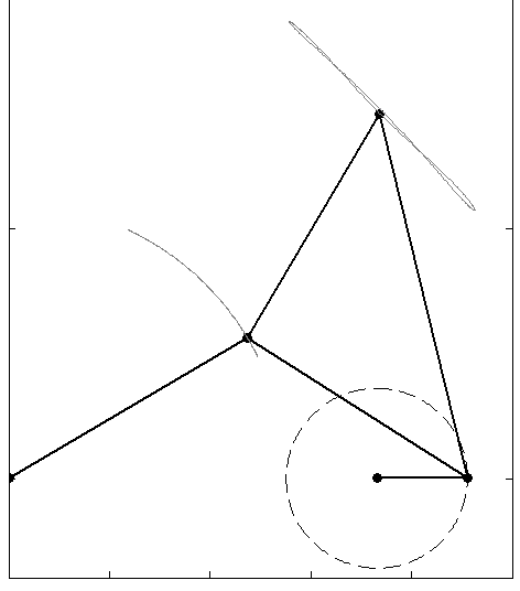

I have solved same problems by help not numeric but symbolic math of Mathcad.
No problems with TOL & CTOL & Guess value - one problem: choose one formula from two possible!
See please
https://community.ptc.com/t5/PTC-Mathcad/New-art-form-with-Mathcad/m-p/537923#M178863
and an article
And with the triangle. You need it!
(ПравИло Чебышёва)
Special for you!
Numeric vs Symbolic solution.
