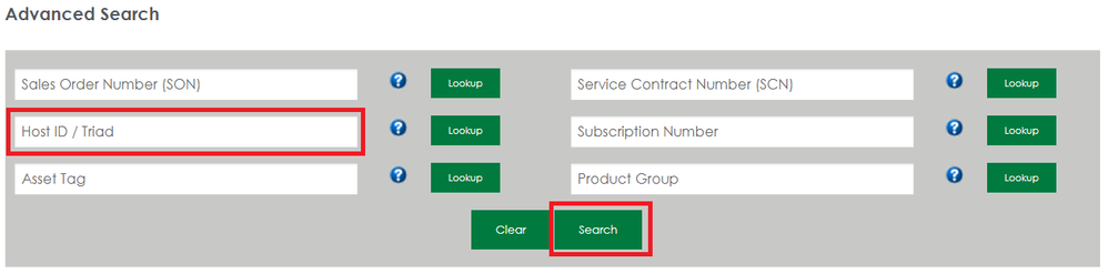

  • enter old Host ID and click Search button
  • table of ordered items appears ... select Mathcad item and click Move License button
  • use displayed page to move the license
