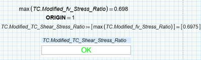

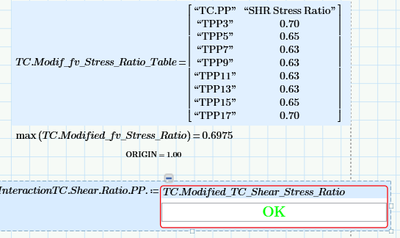

Hello All,
I’m not sure why the textbox result in P10 doesn’t have a red box around it, while the one in P11 does.
In P10
In P11
Sam

I am using 11.0.1.0. I have attached two small sheets for comparison.

Ah, I wasn't sure if I understood correctly what was said in the links I provided, but now its clear to me that it seems to be a new bug introduced in the interims version 11.0.1.0.
I have still installed 11.0.0.0 because not knowing what has changed or been improved/fixed I was not sure if it would be worth installing 11.0.1.1.
Your sheets works OK not only when opened in 10.0.1.0, but also in 11.0.0.0.
But I see when I open your P11 sheet that you experienced an error in your 11.0.1.0 (it goes away in 11.0.0.0 after recalculation).
So I fear you will have to wait for P12 for a fix and in the meantime you would have to use the workaround described in the thread I linked to. As I understood its necessary to temporally set ORIGIN to zero in front of an advanced control.  Hope it works for you.
