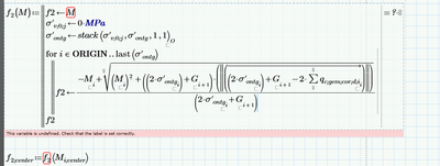

Hi there,
Any ideas why this is wrong? I made f as function of M in order to define it
Regards
Yusra

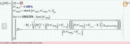

You've still got the "=" sign at the end of the function definition, Yusra.  You need to go to the very end of the function definition (Fn-right-arrow), then press Backspace twice.  That should remove the equal sign.
Stuart

Try getting rid of the following equals sign in the function definition
still the same
Stuart
YA_10963798
(To:StuartBruff)
So I can't put (=) in the function . Thank you for that I didn't know

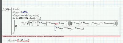

Now I have this another error that I always get . Can you explain to me how to tackle it
No worries.
Without the worksheet, I'd be flying blind, but my first airport of call would be to check whether dzontgr is the same length as g`ontg.
