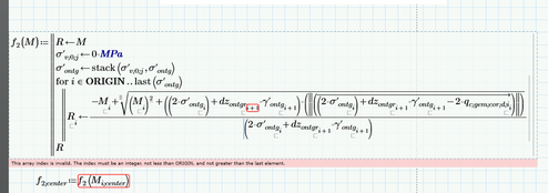

Hi there,
Any ideas why this is wrong? I made f as function of M in order to define it
Regards
Yusra
You've still got the "=" sign at the end of the function definition, Yusra.  You need to go to the very end of the function definition (Fn-right-arrow), then press Backspace twice.  That should remove the equal sign.
Stuart

Try getting rid of the following equals sign in the function definition
still the same
Stuart
YA_10963798
(To:StuartBruff)
So I can't put (=) in the function . Thank you for that I didn't know
Now I have this another error that I always get . Can you explain to me how to tackle it
Without the worksheet, I'd be flying blind, but my first airport of call would be to check whether dzontgr is the same length as g`ontg.
Stuart
Not after a function DEFINITION.
An = means a numeric evaluation. Which numeric result would you expect here:
Prime can't know which value to use for "x". Even if a variable "x" is defined in front it won't work, because the "x" used in the right hand side of the function definition is NOT the "x" you may have defined in front but rather is the "x" used on the left hand side of the definition (formal function argument).
So when you DEFINE a function you can't evaluate this definition numerically. But after the definition, when you CALL the function providing a specific value for the formal argument you evaluate this function call numerically.
Actually you CAN evaluate a function definition using symbolic evaluation.
But this will not always work OK. If the function definition contains a boolean expression using the function argument(s) it can't decide its truth value without knowing specific values and so will refuse to evaluate symbolically
I also suspect that vector dzontgr contains not more elements than vector σ'ontg.
So when in your loop "i" reaches the index of the last value of σ'ontg, there is no element with index i+1 in vector dzontgr.
Probably the same applies to vector γ'ontg.
If all the mentioned vectors are of the same length the error should go away if you use    for i ∈ ORIGIN..last(σ'ontg)-1
The resulting vector returned by your function will have one element less than the vectors used. You have to decide if that's what you need.
