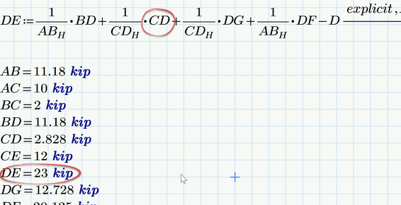

I'm using MathCAD 9.0.0.0. I get this error on my last equation...
I don't know what's off because all of these variables worked fine together up until this point. Initially the box was only around the first CDH until I added "explicit,ALL" so that might be something to look at.

@BB_14100646 wrote:
I just realized I left out multiplication, so I added that, but am still getting an error.
No, you didn't!?
1) You should enable "Units/Constants in Symbolics" in the calculation options. In the first sheet you posted it was not enabled. That was the only difference between the two sheets I noticed.
2) looks like you forgot a factor in the second summand. CDH is just a scalar, all other summands are forces. Maybe the factor should be CD??

Thank you so much!
