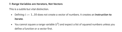

@ppal wrote:
7 Range Variables are Iterators, Not Vectors.
This is a subtle but vital distinction.
Defining i:= 1...10 does not create a vector of numbers. It creates an instruction to iterate.
You cannot square a range variable (i2) and expect a list of squared numbers unless you define a function or vector first.
@RantEng wrote:
I've been using Mathcad for 38 years and I still fall into the trap of trying to use to use a counting range as a vector.
Bob
First point:
And, from years of experience on this forum, that is why when I proposed the Zen of Mathcad, I specifically highlighted Shishin 1 and Shishin 30

1. >>> Range Variables Are Not Vectors <<<.

30. Yes, vec helps, but >>> Range Variables Are Still Not Vectors <<<.
