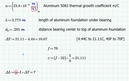

Sorry to post on a subject that others have before, but I am getting wrapped around an axle and could not understand the prior posts.  How do I turn my alpha variable into a scalar or matrix?  I've tried to highlight the number and units then select 'matrix', but that did not work.
I would greatly appreciate some direction.  My Prime 8 file is attached and a screenshot is below:

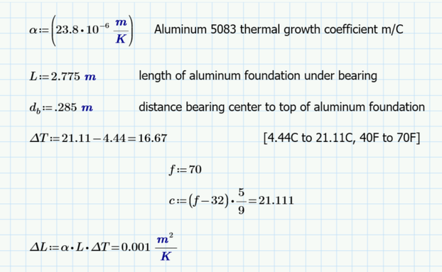

Thank you so much!  Way simpler than I thought it would be

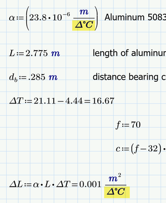

Thats exactly why we have units°C and Delta°C (= 1K)  😉
