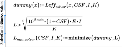

I have a problem in Mathcad. As the picture shown, it always says "This function requires at least 4 arguments but it applied to 1". Can anyone help me? Thank you

The error message is tied to this:
The definition of Lmin_solver is:
Which means that Lmin_solver has 3 parameters, but none of them are used in its definition. What is used in its definition is Leffsolver, That is not a simple parameter or array, but a function, defined as:
So Leffsolver needs 4 parameters, you use it in minimize, but supply only one parameter: the L. That's not enough.
You need to supply 3 more parameters to the minimize function.

I see that you wrote "Given" in front of the definition of L.min_solver. So I guess you are retyping something which was created in Mathcad (version 15 or below) where "Given" would initiate a solve block. This changed completely in Prime as you would have to insert a solve block via the menu - "Given" is obsolete.
But "minimize" does not require the usage of a solve block anyway and can be used stand-alone if no additional constraints should be applied.
The problem seems to be that on contrary to Mathcad, Prime does not allow for incomplete functions in "minimize".
So I guess that a suitable workaround is using an auxiliary function like shown below
BTW, the sole definition of Leff.solver seems to be the rearrangement of the arguments so that L is the first one. This was done to allow Mathcad to fill in the missing arguments automatically when minimizing just for L. As this does not work in Prime anyway, you could abandon Leff.solver and use Leff.function right away if you like.

I've told my boss about contacting PTC, but there's still no decision. But I have tried your suggestion about converting the shortened file. Some functions are working, while waiting for a decision I tried to do the migration by myself.
Actually in the MC15 file, the expression is between Given and Minimize. Thanks for explaining, I finally understand.
