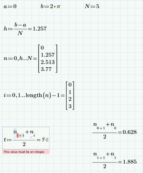

This value must be an integer problem in two step ranges
Cornel
EDIT:
I understand that in the first case I take for i a column matrix:
And in the second case I take:
How to loop the n column matrix in t?
ttokoro
(To:Cornel)
You are using i+1,  t[i must from 0 to length(n)-2.
1 REPLY 1
ttokoro
(To:Cornel)
