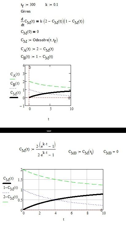

This variable must be a function but has the form unitless
JPark6

Don't post just pictures - attach you worksheets.
You are using the wrong syntax for odesolve - look it up in the help.

can you explain more detail?
-MFra-
(To:JPark6)
You should write k multiplied by....and not k(
