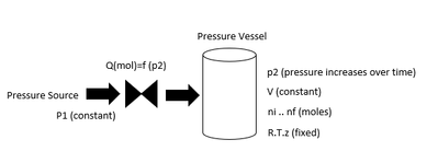

The problem I’m studying is a very real and common situation of cascade gas filling.
It consists of a source (infinity size for simplicity) feeding start-empty vessel (1atm) thought a regulator valve that obey a function critical or sub-critical flow rate f(Delta P), until both source and vessel pressure are equalized. Then plotting a Pressure Vs Time for that system. The pressure would ramp up (critical flow), then level horizontal to zero flow as the pressure accumulation at the end.
I want to keep the math simple, in the future to add z-factor for the gas compressibility factor.
p1=pressure source
p2=pressure vessel (to be filled)
T=temp (constant)
V=vessel volume
Cg=valve flow capacity
SG=relative density
MW=gas molecular mass
ni=mole at P_tank empty (1 atm)
nf=mole at P_tank full (P_tank=P_source)
P=n*(R*T*z)/V, (R,T,z)/V = constant C1)
For each infinitesimal time step, the flow rate will drop after entering sub-critical condition, as the pressure of the tank goes up until, it equalizes with 0 flow.

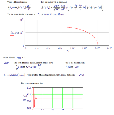

You should not let 'an IF statement' scare you off from writing and solving a differential equation. See example below:
I'm NOT saying that this is the solution to your specific problem. But I AM saying that if you can write your problem in terms of a differential equation, even if it involves a function with an IF statement, that Mathcad (and Prime) may be able to solve it.
I'm not fluent in gas flow, so I just took a (simple) differential equation to make my point.

If you can write your problem in the form of a differential equation, Prime should be able to solve it for you. I don't see a differential equation yet...
Incidentally: If you are going to learn Prime, be sure to understand 'labels' of variables. You define R (the Gas constant) , but Prime already knows it, as:
Note that the R is green and bold, it's labelled as a Constant, it's different from the R you defined:
Which is labelled as a Variable.  You find labels in the Style section of the 'Math' ribbon... Take good care of those labels, since Prime always tries to auto-label what you type. And everything that goes automatic can go wrong automatically, and with Prime that happens more than you'd like: It happens with your i on page 2 where you define i as a range. That i is labelled as a Variable. Then when you define p2i, the i in the numerator is labelled as a "-", which means it's automatic, but this also means it's different from the range i.
That however is not the cause of the error you see there. The reason for that is that you've used a literal subscript for the i as part of the name p2i, If you want to use i as an index to p2, you have to use index notation which you get by typing p2[i.

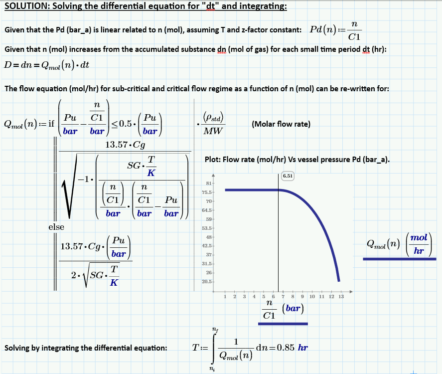

Again many thanks Luc,
Indeed, I was scared without reason. Trying to solve symbolic gave an error that made me stop before digging deeper.
Your solution looks very neat and elegant, I will get inspiration on that.
I think I got it right after rewriting the flow equation for mol "substance", instead of the pressure building. Used a constant name C1 to gather V/(RTz), so the pressure is linear related to the mol flow. That gave me mol/s, and the differential equation was easy integrating.

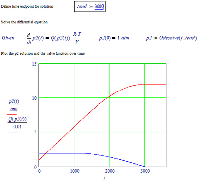

I gave it another try:
Now we can solve p2 pressure over time:
Note that the end time is between 2984 and 2985 seconds, that is 0.83 hr.

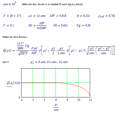

Wonderfully made, Fred. It gives a new perspective using the sonic equation and Cp/Cv.
The gas on the example was natural gas, and the regulator does have a very small orifice, I used this small size to create a very slow compression and keep the process isothermal for a typical 100L tank. At my stage of learning MathCAD, I would not even consider dealing with change at Temperature (and also z) during pressure build to compare to a real-life application.

There are various ways to solve differential equations; the one (perhaps) best suited to your approach is the one that Prime Express can still do.
Attached is a simple example, a damped harmonic oscillator.  The equation is solved by taking small time steps, the "trick" is the yellow highlighted vector set of equations.
