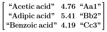

You can copy & past this matrix by select all to combo box.

I am attaching a worksheet with a working combo box and data from Excel using READEXCEL.  Can you please help me get that data into a new combo box on the same worksheet?
You had suggested that it is possible to copy and paste a matrix to a combo box but I can't get it to work at all.

I added all data from excel sheet.
Prime 8 sheet attached.

Thank you so much.  I have tweaked what you sent for my needs and am very pleased with the result.  I have attached the final version in case you would like to see it.
I would hate to have to set up combo boxes on a regular basis though.  It is shame that there isn't a better way of doing it in Mathcad, and I know that somebody else was trying to do something very similar and ran into the same difficulty.
One last little niggle - it is a shame that the names of the acids are displayed with quotation marks around them.  I don't suppose there is a way around that, is there?

The acids are displayed with quotation marks around them. If without quotation, we must define each variable name and its value.
I think the variable name has no space (,), and numbers for first spell.
