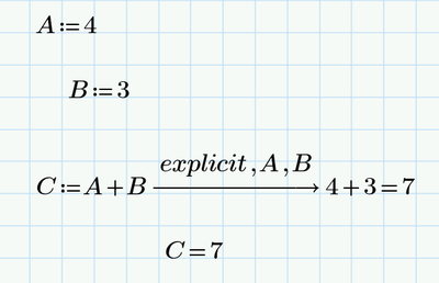

If I type the equation using variables, Is there a way to get MathCAD to automatically show the values in the equation before it calculates the answer?
For example, I set the variables...
A:=4
B:=3
...then I type the equation...
C:=A+B=
...then MathCAD automatically adds "4+3=7" so it looks like...?
C:=A+B=4+3=7
...Then if I change the variables...
A:=23
B:=45
...MathCAD automatically updates...?
C:=A+B=23+45=68

Closest that I can get uses the symbolic keyword explicit.
Read more: https://support.ptc.com/help/mathcad/r11.0/en/index.html#page/PTC_Mathcad_Help/example_displaying_explicit_values.html#
https://support.ptc.com/help/mathcad/r11.0/en/index.html#page/PTC_Mathcad_Help/example_explicit_calculation.html#

As @DJNewman  already said you would have to use symbolic evaluation with "excplicit". Instead of mentioning each variable separately you may also just use "explicit, ALL".
Unfortunately the arrow and the keywords showing does not look nice in a report.
In legacy Mathcad (Mathcad 15 and below) we had the option to hide the keywords and show an equal sign instead of the arrow.
So instead of
we could make it look like
I vaguely remember having  read here that implementing a similar feature is in the queue for Prime, too. Not sure, though.
I'm very new to MathCAD, so once I discovered "explicit" can be found at "Math > Operators and Symbols > Symbolic > Keywords," it worked great! Thank you!
