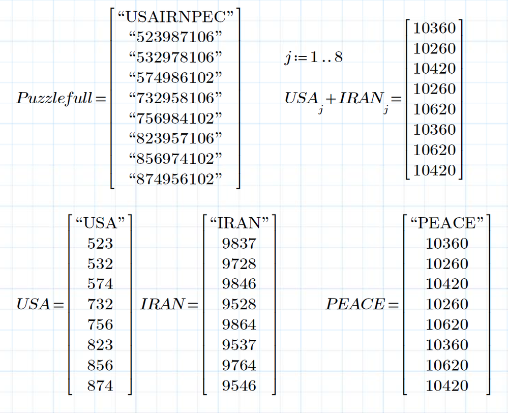

Yes, this puzzle is unusual. A typical puzzle like this has only one solution. And this puzzle has eight solutions.

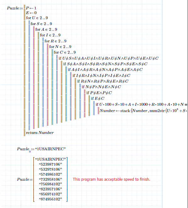

Please show your solution by picture - I have not yet installed Prime 6 for myself.
My solution in attach.

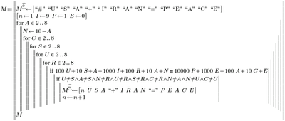

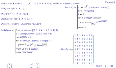

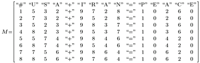

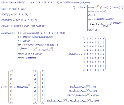

Will this do for a more 'elegant' program?

Thanks. Any way this sheet finish in few seconds.
My solution

Is less than 15 seconds not fast enough?
