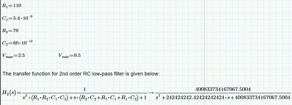

Hi

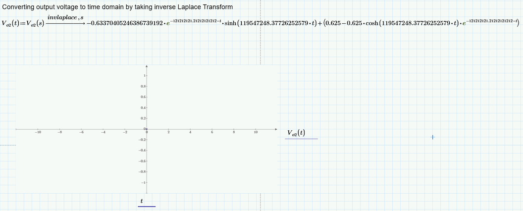

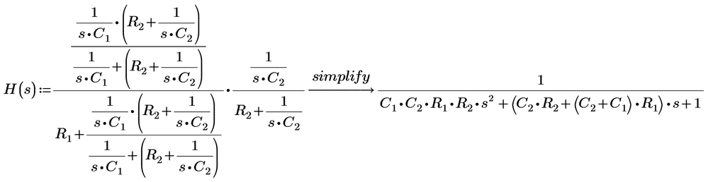

Please find the attached mathcad prime worksheet. I am trying to plot Vo(t) vs t. An error stating "Plotting failed. Replace complex numbers and NaNs by real numbers is showing. Kindly help me to resolve this issue.
I am using Mathcad Prime 8. From Prime 7, Laplace and Fourier transforms are version upped. You can read PDF of my file.
Anyway, h(t) is almost impulse, and the response is as same as input signal. Using convolution technique by * in Mathcad, the signal delay is about 3 microseconds.

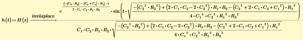

As you can see the result of invlaplace contains limit operators (n->infinity). These limits can only be evaluated symbolically but a plot requires numeric evaluations. So the plot must fail.
Try yourself and type V.o(0.3)= and Prime will fail with an appropriate error message.
After all this means that Primes symbolic is not capable enough to find a decent representation of the inverselaplace transfomed. The result Primes symbolics returns is useless, it can't neither be evaluated symbolically nor numerically.

Actually the limit operator is also not helpful if you try to symbolically evaluate Vo(0.3) as the result of Primes symbolic is just kind of a building plan how to derive the invlaplace transformed if, yes if we could simplify that derivation limit.
It just means that Prime is not capable enough to give you the answer you are asking for.
I tried with the legacy symbolic engine which is available up to Prime 6 and it wasn't able to come up with a solution function either
(but it shows that a bit more clearly that its not capable enough):
So at the moment I see no way to derive the output voltage using invlaplace with Prime.

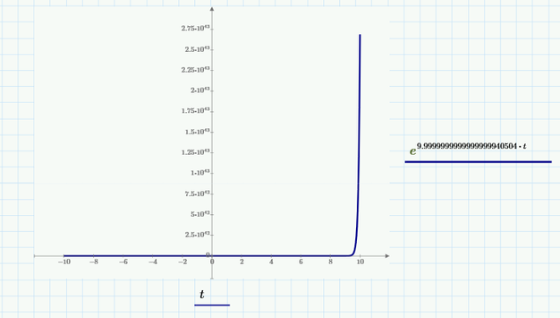

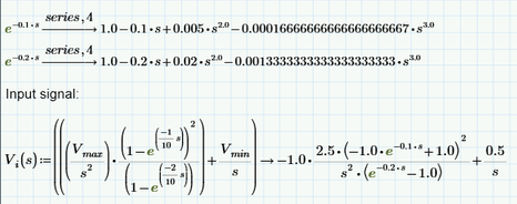

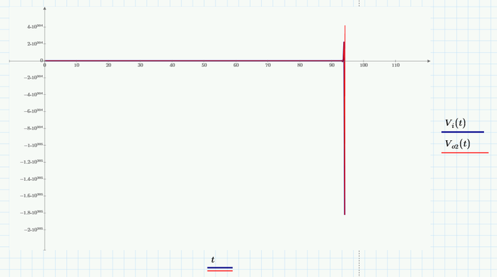

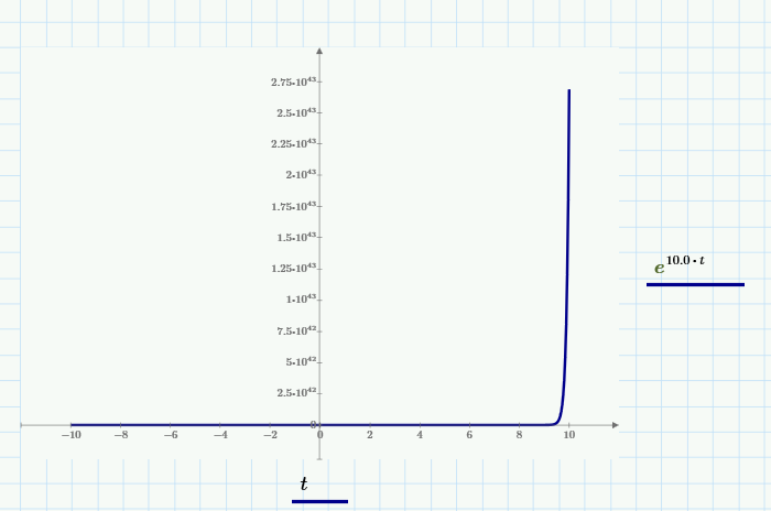

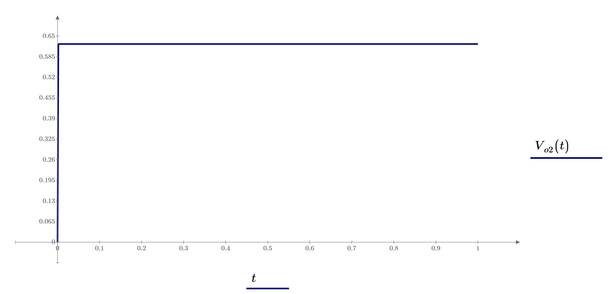

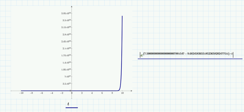

Hmmm, the argument for sinh in your V.o2 is so large that for every value of t (other than t=0) we have an overflow (value greater than 10^308). Thats the reason the plot consists of just one point at the origin.
I am not sure if linearizing the exponential functions give a meaningful result, but adding a "simplify" will at least make the whole thing plot:

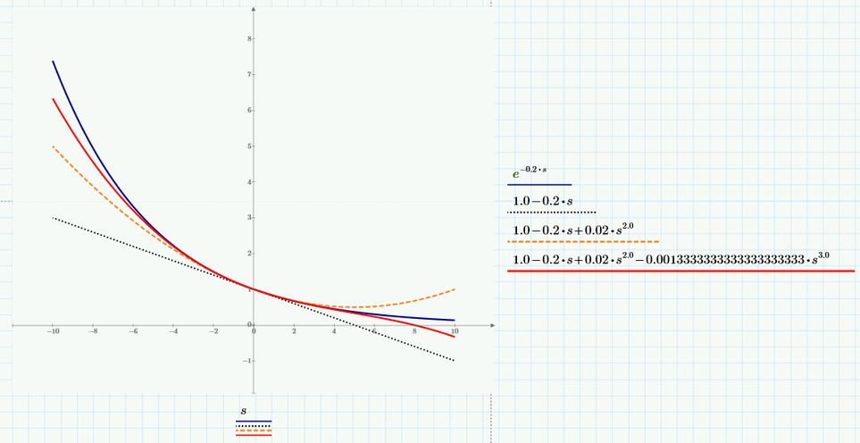

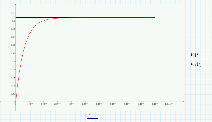

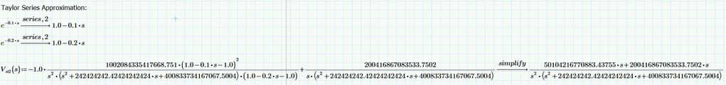

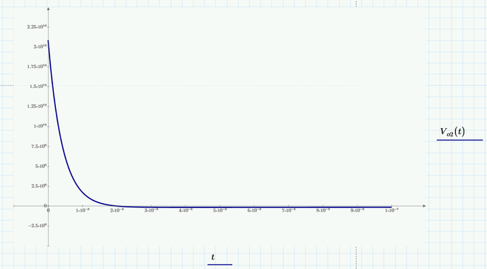

If we use series, 4 approximation (which seems to be a good approximation for e^-0.1*s and e^-0.2*s) then te result is:
@LucMeekes
Mathcad Prime 7 file attached.

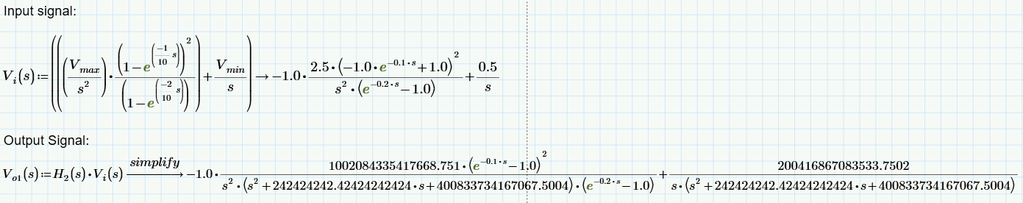

Thank you for the response @Werner_E .I discussed above, the issue I faced while plotting the Vi(s). Do you have any suggestion on this issue?

Thank you for the response @Cornel. I tried using your methodology and it is working, the only issue was that as @Werner_E said in the below response that 10^308 error was showing. So, I used the simplify symbolic also, and then it is working. The same methodology I tried to take the inverse laplace transform of Vi(s), but the following is the error showing up: I don't understand why is this "s" term coming in the inverse laplace transform term. What does this delta(t) mean?

Looks to me like the two "s" in the result of Vi2(s) are not labelled the same (a common bug in Prime).
Can't be told just from the pic, though.

As @Werner_E wrote, it's probably about the fact that you don't have the same label for every s in your laplace equation. Some of the s in your equation have the label "Automatic", while others are likely labeled "Variable".  But you must have the same label for all s of your equation (whichever label you want, you choose the label you want to use) to receive a correct answer. Always put a worksheet of Mathcad.
And I think the most likely correct answer to your problem is that in which you use series, 4 approximation because series, 4 approximation well approximates those exponential function, instead of series, 2 approximation.

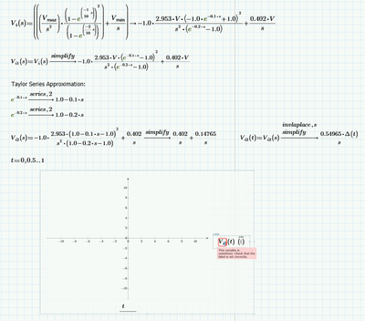

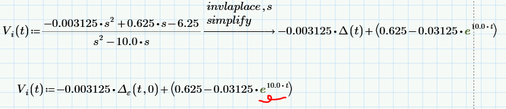

I think the problem with the fact that Vi(t) is not displayed, meaning that error occurs: "This variable is undefined. Check that the label is set correctly", is I think because we have to define that delta(t). How can we define this delta(t)?
(To:Cornel)

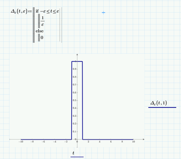

The Dirac unit impulse Delta(t) is a symbolic only function.
You may write approximating function (very narrow spike with area underneath=1). but I don't think that this would solve the problem here satisfactory.

I see the situation in principle like this: we should made a function by which we can use this delta(t) even numerically (not only symbolically), and then see what result gives Vi(t). But someone has to create this function through which we can use delta(t) even numerically...Maybe @ttokoro  knows (idk), I do not know how to create this delta(t) in such a way so that I can use delta(t) numerically, in calculations.
(To:Cornel)
You may try the approximation given here and in the follow up posts and see, you arrive at a meaningful result here.
https://community.ptc.com/t5/Mathcad/How-to-solve-a-RC-circuit-including-piecewise-and-periodic/m-p/331828/highlight/true#M129735

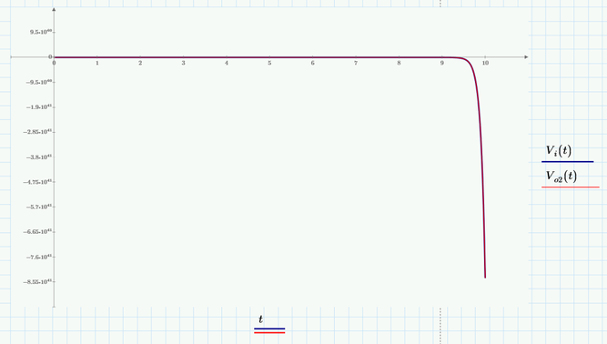

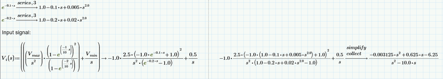

Case 1: Using series, 2 approximation:
Case 2: Using series, 3 approximation:
This is because of:
Case 2: Using series, 4 approximation:
This is because of:
And in the output we also can see:
So, Vi(s), Vi(t) is an unstable input as it is.
Only if we approximate those e^-0.1*s and e^-0.2*s with series, 2 approximation (so, with a linear expression) - series, 3 and series, 4 approximation are nonlinear expression - then Vi(s), Vi(t) and Vo2(s), Vo2(t) become a stable input and stable output.

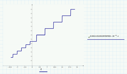

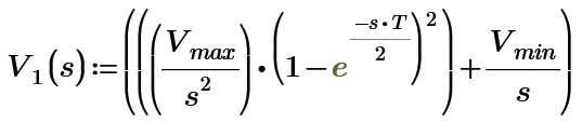

I guess essentially I was asking: How did you come to the expression for the Laplace transform of your input signal?
Since it is not common to have/know only the Laplace transform. All in all this is assuming you're dealing with a real-world problem, and not some pure theoretic set-up.
The reason I'm asking is because that Vi(s) contains expression parts that are quite uncommon for the Laplace domain: the (1-exp(-a*s)) occur in signals with a step and staircase shapes.
Seems like your input signal is the double convolution of a box and a staircase.
Cornel
(To:LucMeekes)
For example, we can see that in the case of series, 2 approximation, in Vo2(t) we receive a term that has staircase shape.

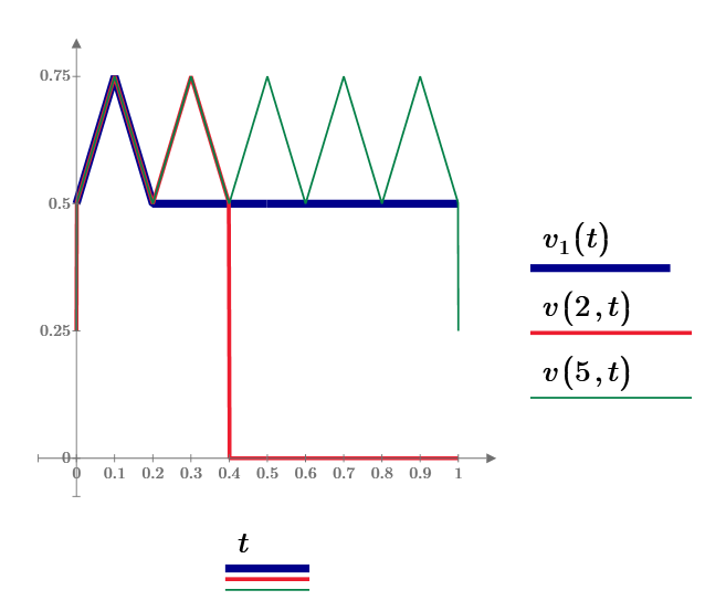

Hi @LucMeekes The input is a DC shifted triangular wave.
Maybe input signal is infinity number of triangle waves shown in green plot but that only shows 5 waves.
But cannot get Vout(t).

Hi @ttokoro this is right. The input signal is a triangular wave. May I kindly know why you are saying that Vout will not be obtained.

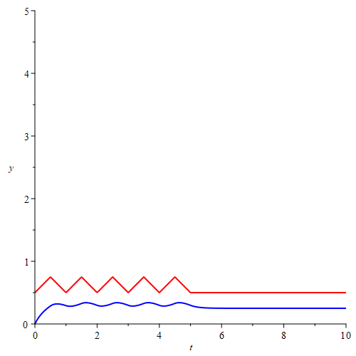

The Laplace transform of a repetitive waveform with a period of T is
where, V1 (s) is the Laplace transform of a one-period waveform.
Unfortunately, it cannot inverse transform to t domain waveform. Therefore, we must use finite number of Laplace transform of voltage waveform.

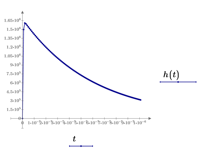

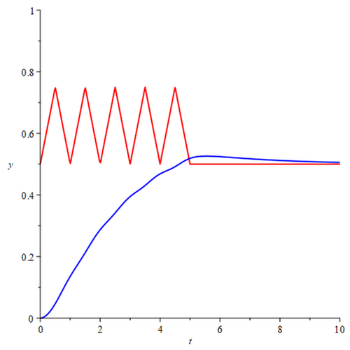

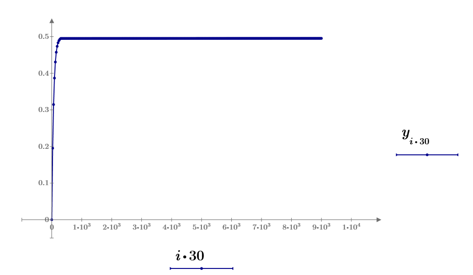

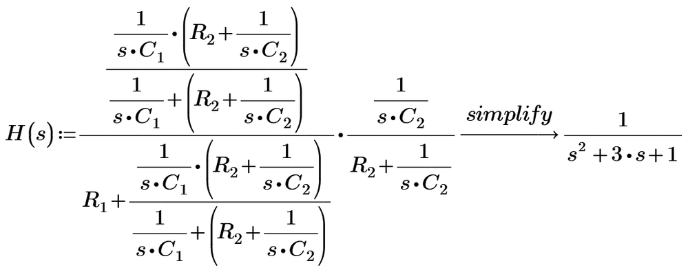

Left plot shows the transient current response of RL Circuit. (R=1, L=1)
Right plot shows RCRC circuit response of all is unit value.
In this case Mathcad can solve the answer. (In these plots, I use Maple2022 because it is faster than Mathcad.)
But using your R and C values, it shows nothing because C and R are so small and immediately charged to the applied voltage.
I think the time constant is so small and numerical calculation is failed.

I tried plotting the vi(t) equation as shown below but unable to plot v(2,t) like you did. Can you correct me? I want a triangular waveform ranging from 0.5V to 2.5V.
Output voltage of the system.
After about 3 microsecond, output signal is as same as input voltage of infinity triangle train.
Prime 8 sheet attached.
