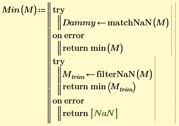

So, we should do.
(To:ttokoro)
@ttokoro wrote:
So, we should do.
This does not help much as it still fails if NaN is the first entry of the vector!

ttokoro
(To:Manfred_F)
Using vector M, Edit: Without NaN fix.
(To:ttokoro)
Which results do you get when you use a vector without any NaN's? 😉
EDIT: AH, I see that you have editted your post and fixed your functions to deal correctly with that case 😄

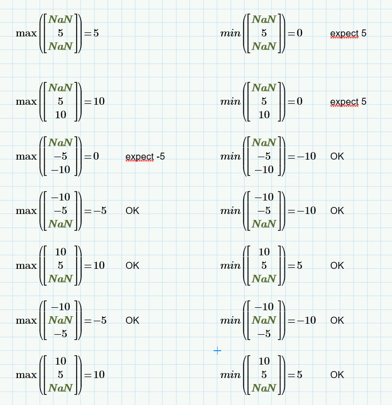

Manfred_F
(To:Werner_E)
I would expect that min() or max() filters out the NaN and calculates then min/max from the rest. If there is no value left (all values are NaN) then the result should be NaN. I tried several combinations and it seems to depend on the sign and position of NaNs:
LucMeekes
(To:Manfred_F)
It looks as though it checks vectors on NaN's only for the first element, and when found, the NaN is replaced with a 0; scalar NaN in min() and max() is replaced with a 0 as well. NaN's appearing elsewhere in the vector are discarded.
Fortunately NaN is retained in other functions, one way or another...
It's a bug.
