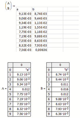

What kind of problems do you experience?
When I open your sheet it seems to work OK (Mathcad 15, Excel 2016)
Hmm. I get that A and B are undefined and the error message "The range value specified is invalid"
