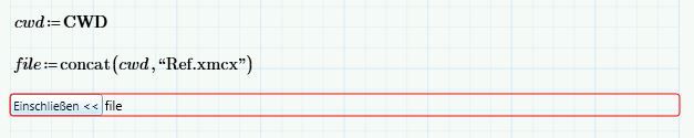

Nice try. Unfortuantely it looks like the include reference function does not accept ascii string. Also I found this other thread, saying that there is no solution for this issue:

Thanks for clarification, Fred. What I'm trying to do however is to  use the CWD variable in order to include another worksheet file. This would imply that I could, in some way or another, use this string variable (file) as a path to the referenced file. Which is not going to work, as you can see:

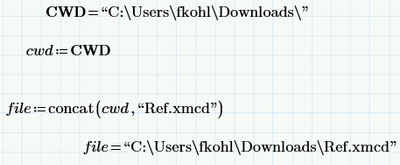

This method would work for readfile commands, the ones that read in data.  I think you're trying to include mathcad calculation files--the ones that are basically "copied" into the open file.  And you're right, that has never worked.
