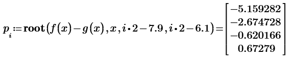

(To:JA_9803374)
@JA_9803374 wrote:
Hey, I'm just wondering if this finds the intersection points of these two functions which gives 4 different sets of values. Sorry, I'm pretty new to Mathcad so I'm still learning how to implement all these things.
Prime is not able to find all four solutions automatically.
You have to provide either appropriate guess values or ranges, as ttokoro's picture had shown.
You can use the "root" or a solve block with "find".
In the example below I turned the solve block into a function of the guess value for x (the guess for y is constant 0).
Given the estimates you provided its possible to find all four points of intersection:
But of course you can find the same values using your own "Newton" function.
I assume you already corrected the above mentioned errors.
