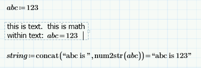

You can include a math region within a text region.  Or, you can convert a number to a string and concatenate it with other strings.
If you want the actual contents of a text region to change, it might be possible with scripted components in Mathcad 15 (or prior).

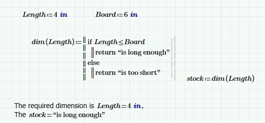

Perhaps you want to use a combination of inserting areas (Math/Text region):
You can imbed a math expression in a text block.  So changing the value of a number in text is do-able.  Rewriting text because of a variable change would be a challenge.
