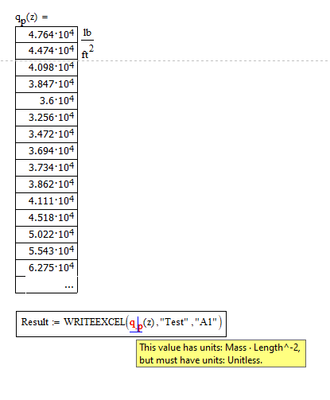

I'm new to Mathcad and have just taken over a file from someone at work. It runs fine but I am stuck manually copy pasting the results into an excel sheet. I want to automate the process and have tried using the WRITEEXCEL function but I can't seem to get it to work. See attached photo.
I believe it has something to do with the function qp(z) not being a matrix or array but I'm not sure. I've also tried defining M:=qp(z) and using M in the WRITEEXCEL function but that gave me a "variable is not defined error".

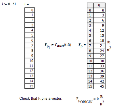

It's not possible to divide a unit out of a range variable:
Note that range variables are (should be) used only for:
- creating a range for plotting a function
- indexing an array (vector or matrix).
- iterations (as part of a 'for' loop in a program, or using the range on worksheet level).
Nothing else.
We'll use the last option here.
Create a range variable i, and use that to (iteratively) create a vector result of your function:
Note that I (deliberately) created the vector as a literally subscripted variable Fp (I typed
F.p
to get that), then added an index to it by appending:
[ORIGIN
This to show you once more the difference between a literal subscript and an index...
Anyway, now you have a vector result, but it still has a unit, and you cannot export units to Excel, so you'll have to divide that out. With an array that is possible, and it can be done as:

As Excel does not understand units, you can only write dimensionsless data to an Excel file (the error message also tells you, that the data must be unitless). So use q.p(z)*ft^2/lb  (instead of just q.p(z) ) as argument in the WRITEEXCEL function to get rid of the units. Furthermore I think that the filename must include the extension ".xlsx". Specifying "A1" as starting cell should not be necessary, you can do without.
BTW, its always better to include the worksheet rather than just a picture. I can only guess that z is a range variable!? If thats the case, the export will not work even when using the correct syntax and unitless data. This is because q.p(z) is NOT a vector if z is a range. That may also be the reason why M:=q.p(z) does not work OK. The argument of WRITEEXCEL must be a vector!
It would be necessary to see the sheet for further help, though.

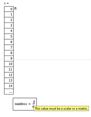

JB_9974851
(To:LucMeekes)
I apologize as I'm probably trying to jump several steps without really ever having done any training or tutuorials with this software.
I used your method and found that z and qp(z) are not vectors. That would probably mean z is an index and qp is a range variable correct?
z had units of ft so I tried to define a variable zunitless :=z/ft but got the below error message. I believe this is because I need to define zunitless as an index?
LucMeekes
(To:JB_9974851)
Nothing else.
F.p
[ORIGIN

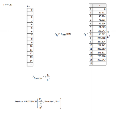

JB_9974851
(To:LucMeekes)
It worked! I had to tweak a few things.
Thanks a ton!
