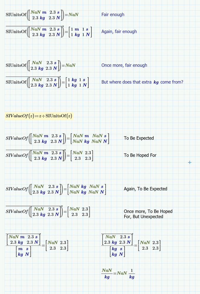

Whenever I think I might be making progress, I hit something that causes me to scratch my head slightly.
This time, it's one of NaN's apparent idiosyncrasies.
SIUnitsOf returns NaN when applied to mixed unit matrices, which is somewhat limiting.
So, having spent a few happy moments programming Yet Another New Version of a function, this time SIUnitsOf, I was reasonably happy with its behaviour.
Then I thought I ought to keep my hand in writing Express-friendly functions and sort of succeeded.
I say "sort of" because I noticed an anomaly: vectorizing SIUnitsOf over a mixed-unit matrix with a pure NaN threw in a spare unit where none was supposed to be.
I've played around with various positions of NaN within the matrix, and it looks as though SIUnitsOf returns the unit of the first element to the NaN under vectorization.
The first question is clearly, "Is this 'anomaly' to be expected?", in which case, what am I not understanding?  If it is unexpected behaviour, is it a bug?
Mathcad Prime 10 worksheet attached.  I've checked in Mathcad Prime Express 7, and the same behaviour is evident.
Stuart

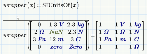

I wouldn't have expected these effects, either, but I am not really sure if its a bug but possibly it is.
Prime got rid of SUC but it looks like they tried to make it a bit more comfortable by implementing ways so that Prime would guess a necessary missing unit. Maybe the root for some anomalies lies in the attempt to make strict dynamic unit checking a bit less troublesome?
NaN seems to behave similar to Zero (with capital "Z").
BTW, I find it strange that zero and Zero are not covered in the help pages but only in the Migration Guide.

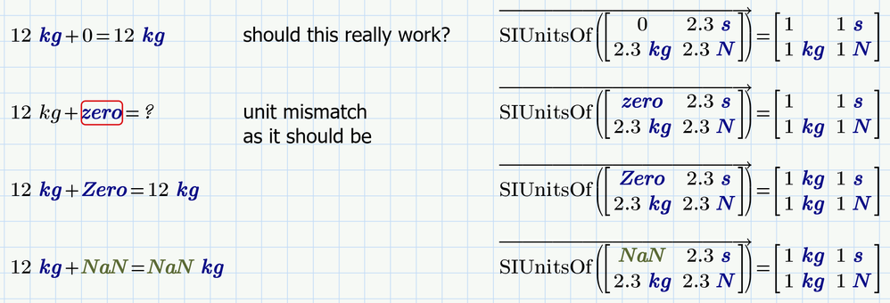

According to this, zero should be dimensionless 0, but zero seems to be more strict than 'real' dimensionless 0, which sometimes (but not always as many questions in this forum prove) also behaves as Zero, as the following screenshot shows.
In case of a matrix with mixed units the unit of the first non-unitless-zero and non-NaN entry when the matrix is read columnwise as usual seems to "win"
What really surprises me is that I thought that vectorization would feed one value after the other into the function and so no value would be aware of any other. But this seems not to be the case.

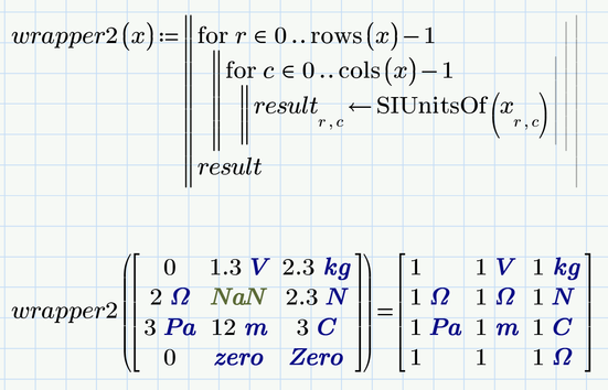

As we know  there are some functions which cannot be vectorized and the usual way around is to use a wrapper function and call this vectorized.
But this does not work as expected in case of SIUnitsOf
So I ask myself what did i not understand about how vectorization would be implemented?

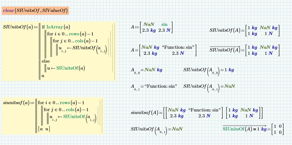

I'm now puzzled as to where the function sin picked up its base dimensionality ... ah, looks like the evaluation of the result, whereas the NaN picks up the unit during assignment.
Interestingly, if you take a nested array whose deepest (base) elements are scalars, multiply it by 0, and evaluate it, then you get the nested array structure with 0 for the numerical values but the original units.  Off the top of my head, I can't think of a neat way of making use of this structure without having to do some recursion anyway.  Plus, extra work will still be involved in dealing with non-scalar base elements.
