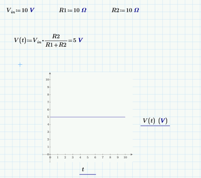

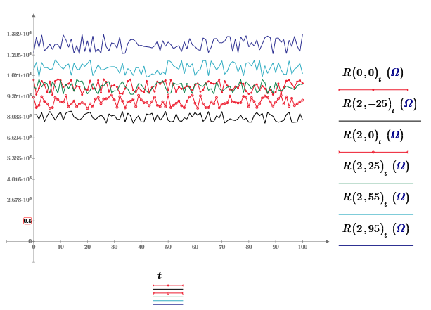

Can anyone provide solution for above problem?
Best answer by ttokoro
March 20, 2024
The slope of a voltage vs time graph can be calculated by taking the change in voltage (ΔV) divided by the change in time (Δt). This can be represented by the formula: slope = ΔV/Δt.
23-Emerald I
March 20, 2024
You need more information than you've shown.  What changes with time?  How does it change?
3-Newcomer
March 22, 2024

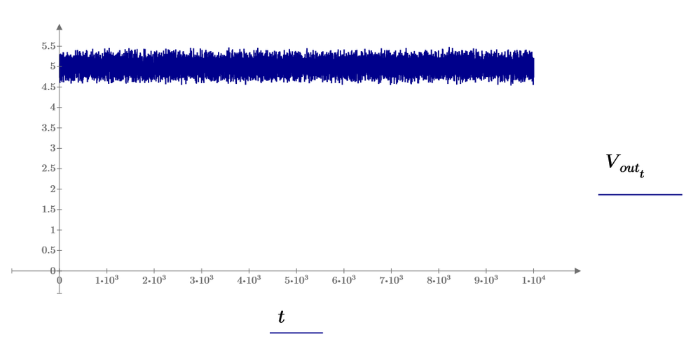

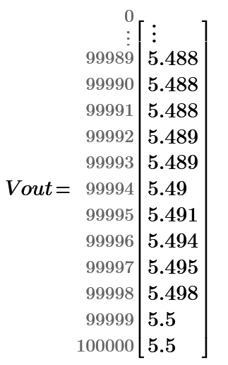

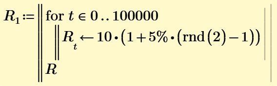

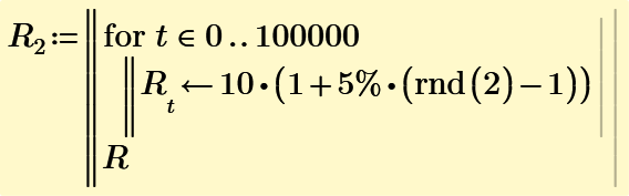

I need to do Monte carlo Analysis of mentioned circuit...I have to generate a matrix with that I have to plot a graph. Vout vs time
Spoiler
18-Opal
March 22, 2024
Like this?
ttokoro
March 22, 2024
Assume uniform distribution. Not use 100ppm for R1 and R2.
t.t.
March 22, 2024

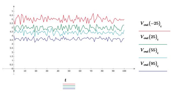

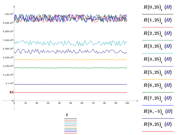

As I see it, the values of R1 and R2 may be chosen within the tolerance of 5% (maybe normal distributed?) but once chosen, it won't change over time.
The only change over time may occur because of the temperature coefficient of +- 100 ppm/Kelvin.
Its unclear if the input voltage would be allowed to change within its tolerance of 5% over time - guess yes.
Its not clear to me what kind of Montecarlo analysis is asked for and what plot of Vout over time? In my understanding, a plot over time would not use the 5% tolerance of the resistors.
