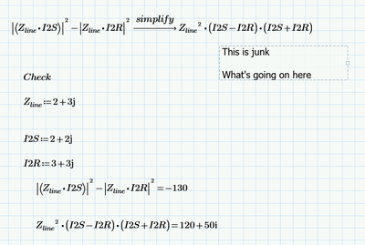

ppal
18-Opal
WHAT'S THE STORY WITH SIMPLIFY
(To:ppal)
The reason is that Primes new symbolic engine does not assume variables to be (possibly) non-real by default.
The simplification is correct for real values.

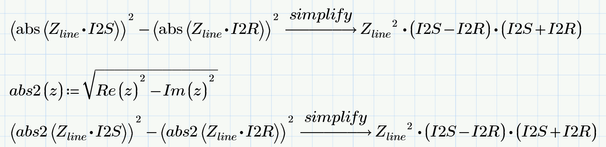

Unfortunately adding "assume, ALL=complex" does not help at all. I think it should help so feel free to call and report it as a bug.
I also tried using the predefined function "abs" and a user-defined function using squaring and root, but to no avail:
So I can't think of a suitable workaround (other than using a different software for that kind of symbolic calcs).
