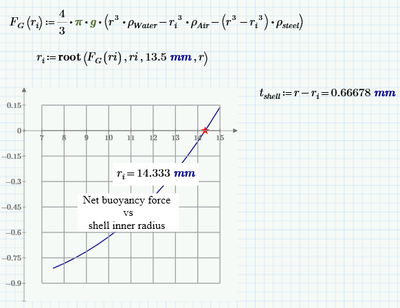

I ask the students a new problem after analyzing the old one - what should be the thickness of the steel wall of the spherical shell in the left glass for the balance to be balanced! H, D and d are given! With plot DeltaG:=f(thickness).

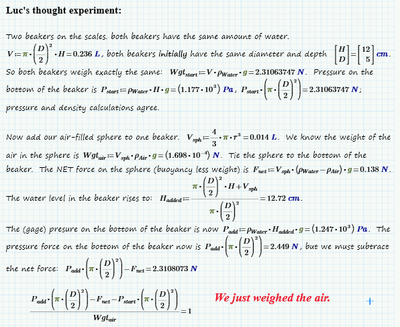

Are you saying (on the left) that if I put two beakers, each containing 1 kg of water, side by side on a scale (you've shown them on top of each other) that the scale will report 1 kg?
Interesting question.
Large beaker has no cap on the top. Therefore, small beaker is hold over the large beaker by someone.
So the weight of large beaker is 1kg.
You understand after put into the small beaker to the large beaker, the total weight is 2kg.

I’m having a hard time keeping the various responses separate, and which problem is being addressed in the response. Below is a revision of my response to the Val’s original problem. I had ignored the fact that the beakers  are in atmospheric air, rather than a vacuum. Looking to simplify things, I ignored the air, and presented the problem as if it were in a vacuum. (I think that my analysis that the left scale would indicate heavier on the scale is correct with this assumption.)
In air, there are additional considerations. Let me number my assumptions and conclusions to make responses a bit easier.
1. The string and steel ball on the right side are red herrings (distractions). Since the only parts of the system supported by the scale are the beaker and its water, these are the only relevant items when analyzing the scale force of the right side. Forces on the steel sphere/support are supported by the structures outside the beaker/scale system.
2. I stand by my analysis of the left side which says that the component of downward force on the scale from mass in the beaker/water/sphere system on the left is just the combined weight of these masses, which - idealized - is the weight of the air in the sphere plus the weight of the water. The buoyancy of the sphere within the water Is an internal consideration, and can be ignored (more accurately, has cancelling forces) when considering the weight of the beaker system mass.
3. What was ignored in my original analysis Is the buoyancy of the beaker system in the air surrounding the system. (This argument presents another chain of reasoning supporting the argument by Luc, and his daughter, which says that the air in the sphere has zero net effect on the scale reading.)
The beaker system in air has a certain buoyancy. This is normally 3-4 orders of magnitude below the weights of everyday liquids and solids. In this case, let’s not ignore it. On the right side, the upward force component  due to the buoyancy of the system in air  (remember just the beaker and water,  not the steel) is the weight of the air displaced by the beaker and water. On the left side the buoyancy of the system in air is the weight of the air displaced by the beaker/water/sphere; somewhat larger. If the air density in the sphere equals the density of the surrounding air, then the weight of the air in the sphere will exactly cancel the additional buoyancy due to the additional displacement volume of the sphere. Then the net downward force on the scale is the weight of the water less the buoyancy- in air - of the water volume. This is identical to the net downward force on the right side, so the scale balances.
4. Now, addressing Luc’s problem of the air sphere on one side and a vacuum sphere on the other side. On both sides, the water weight is the same, as is the buoyancy of the two sides in the surrounding air (same displaced volumes). Since the side with the air sphere has higher mass, and weight, the air side will weigh more on the scale, and lower the scale on that side.
I think I finally have things sorted out where I understand what is going on. Please let me know if I’ve gone astray somewhere.

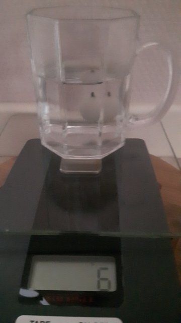

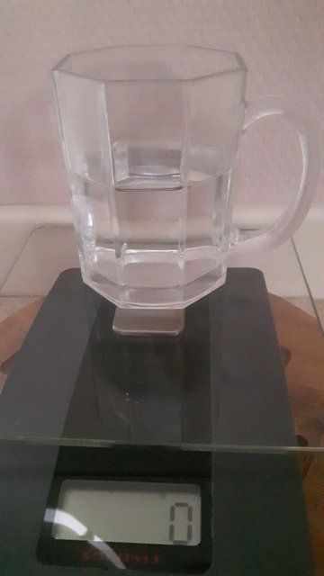

I decided to do an experiment to see what's going on at the right side.
I filled a glass with some water and put it on the kitchen weigher, then set the scale to 0.
This is what you see here.
Then I took a ball (from a computer-mouse), tied to a fishing-string and suspended it in the water. I expected the weigher to keep indicating 0, instead it showed:
So the weight actually increases. I did the same experiment but pressing a measuring cup into the water. (You actually have to press it in, because it wants to float; that's something you don't experience wth the steel ball. This is what, up to now, had sent my thoughts the wrong way). The increase in measured weight was consistent with the scale on the measuring cup. The increase in weight is the weight of the displaced water.
So I must correct my analysis. The right side, with the steel ball suspended to the stand, weighs the height of the water, as if it were all water. Oh, my ball weighs 30 g, and it measures 22 mm in diameter:
There's my 0.006 L, in water that's 6 g.
So the right side of the balance carries a weight of the outer volume of the water, which is
