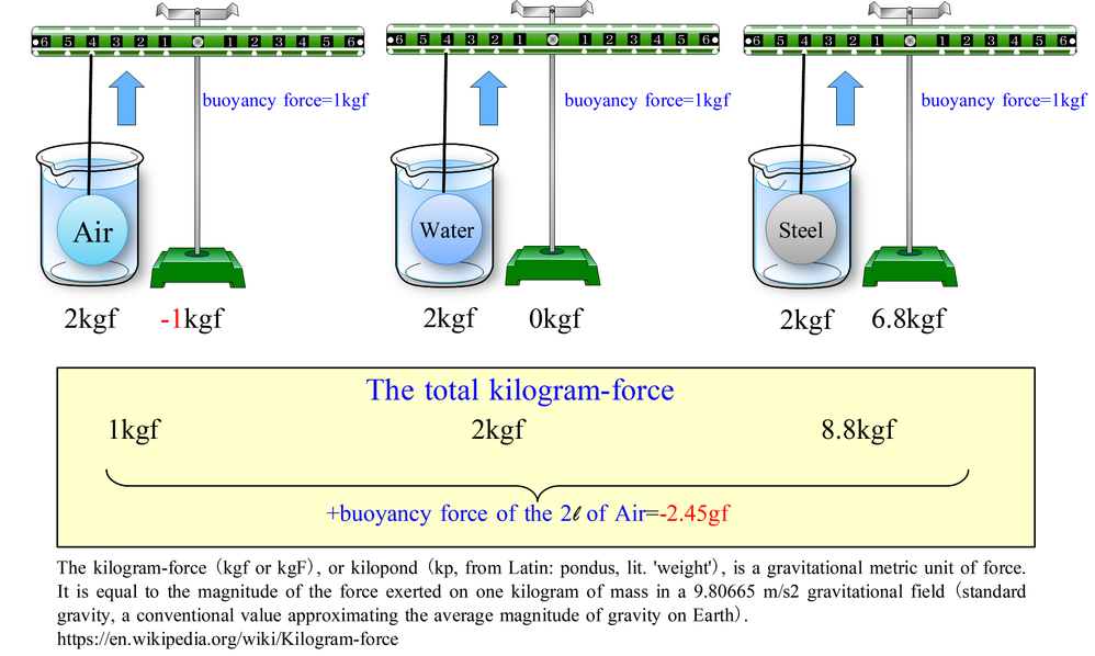

I believe your center scale should read 35.6 gm.  The ball raises the pressure head the same as the right scale.
The center scale should read 0+30=30gm. Not 35.6 gm.
The ball raises the pressure head the same as the right scale, therefore, the center scale should read 5.6 gm+(30-5.6) gm=30 gm. The second 5.6 gm is the buoyancy force of sphere volume.
LucMeekes
(To:ttokoro)
You're both wrong.
It is not 35.6 gm, and also not 30 gm.
The scale reads 30 g.

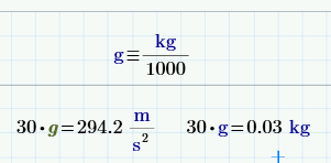

My Mathcad Prime says:
and
if I use it correctly.
I know that g is a unit of mass, being 1 kg/1000, it is defined like that in ISO 80000-1.
The prefix k means 1000, so 1/1000 part of 1 kg gives you 1 g.
The Earth's gravitation at sea level is (defined at?) 9.80665 m/s^2, the symbol g is often used for that value.
Note that there is a difference between g and g.
The unit of length is m and 1 km is 1000 m.
According to common rules Nm is often used as a unit of torque: N*m. Likewise gm can be understood as g*m, that's not a unit of mass, and not a unit of force.
Using gm instead of g as a unit of mass should be avoided.

I well understand what you mean. Using Prime 6, the unit g is 9.8 m/s^2  and gm is 0.001 kg.
These replies are start from Valery's figure and it shows 30 gm instead of 30 g. Then I followed his unit for the weight.
 Any way, our answer is same. The center scale shows 30 g. (or Using Prime 6 it is 30 gm.)

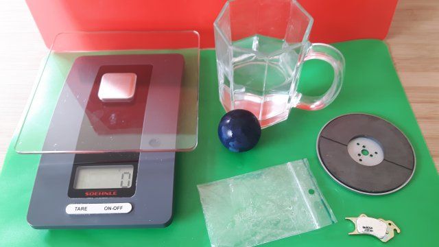

Here's the experiment for the left side.
I took the same beaker and the same kitchen weigher.
Then I grabbed the blue ball that floats in my garden pond, a small plastic bag and a circular and a strong magnet (I don't want to glue something inside the beaker, I decided to let two magnets hold the bag with the ball under water)...
In short: this stuff:
I poured water in the beaker, dropped all the stuff on the weigher and set it to 0.

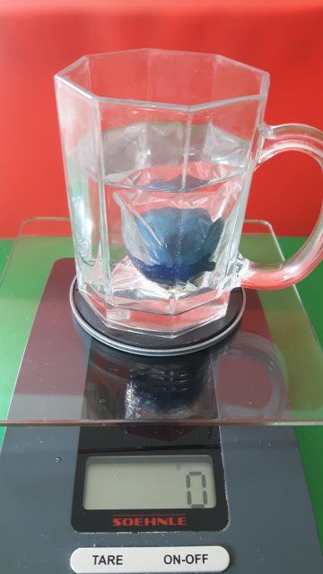

Then I put the strong magnet inside the plasic bag (with the ball) and drowned it. The magnets keep each other together, keeping the ball and plastic bag fully under water. I expected no difference in weight and got this:
No difference in weight, as expected. Now my weight scale isn't capable of weighing the amount of air entrapped inside the ball (and there's still some in the plastic bag). I expect however that even if I could measure that, I would see no difference because, per my former reasoning: air remains suspended in air (instead of dropping on the floor or floating to the ceiling).
This leads me to the conclusion that the left side weight is that of only the water, that is:
A very nicely designed experiment!  But I have one objection (and one suggestion.)
The objection (more an observation):
With the ball floating on top of the water the ball is partially submerged; this raises the water level (see Val's note.)  Better to weigh the ball outside the beaker.
And the suggestion:  substitute a block of wood for the ball of air.  The block should be big enough that the scale can recognize it.  We should be able to see any difference submerging it causes.

Now, FredKohlhepp (Sapphire III) concludes his answer. That's the same as my 08-09-2020 10:38 AM post.
LucMeekes (Sapphire II) also finds his answer.

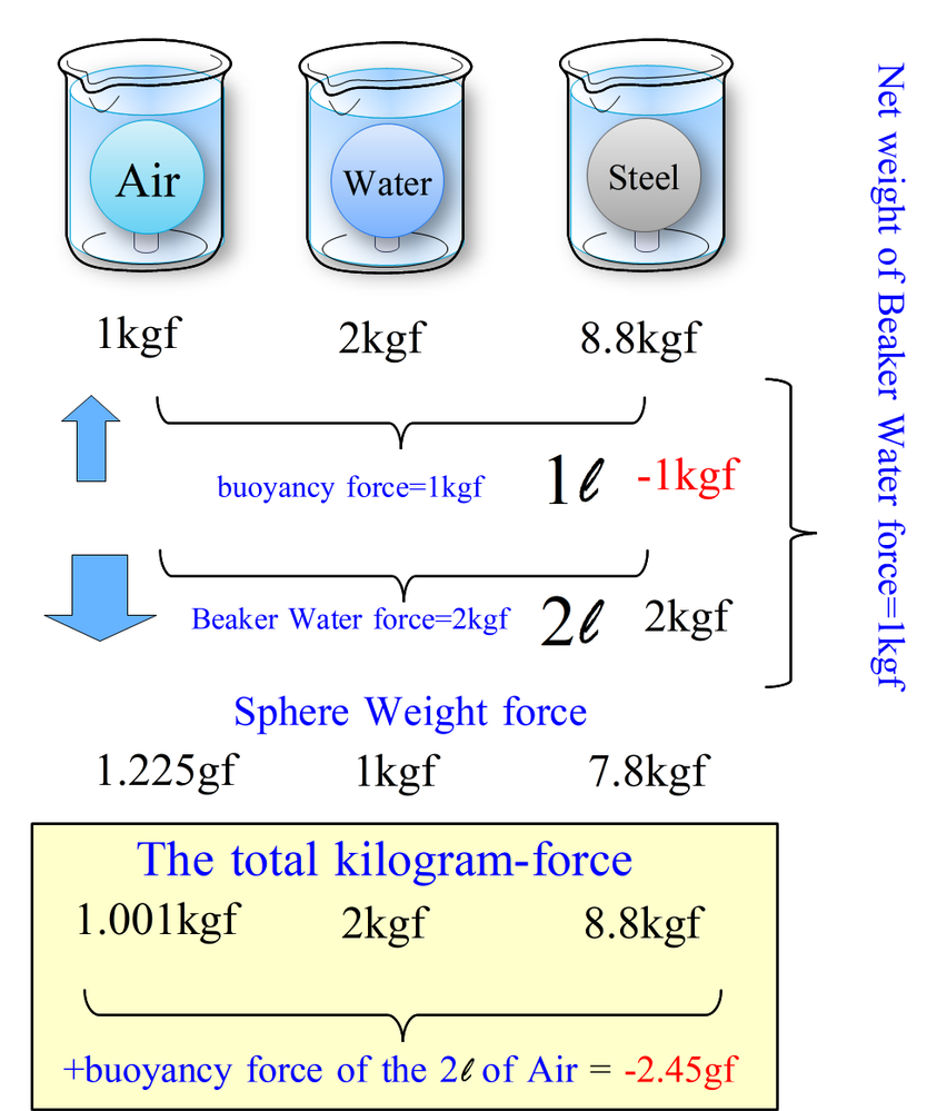

The answer of this puzzle is ValeryOchkov's answer sheet, Air Steel Water End.mcdx.
This is exactly the same as my final answer already posted.
Some differences come from the buoyancy force of the air.
If the density of water and air is the same, it is easy to understand that the weight must be zero.
So using the same density value for air and water, the answers that don’t show zero are wrong for each side.
Right side is heavier 0.13847 N.
Tokoro.

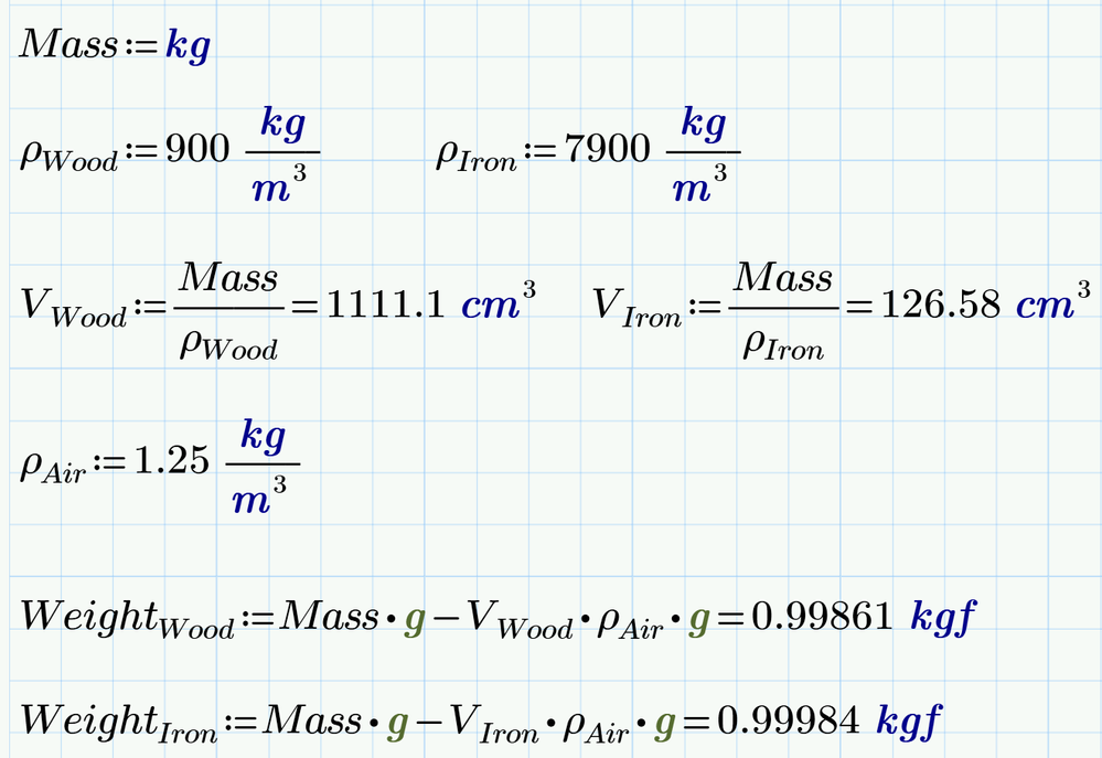

Everyone knows that a kilogram of feathers is heavier than a kilogram of iron. After evacuating the room, that is.
You will laugh, but the weight of one kilogram of iron is more than the weight of one kilogram of wood.
Weight is the force with which an object acts on the scale.
Gravity is mass times the acceleration of gravity.
I know you mean the other way around, but let me have the pleasure to correct you 🙂
And the second line should end with "corrected for buoyancy"- for clarity.
All the best/всего хорошего
LucMeekes
(To:ValeryOchkov)
Which (once more) illustrates that weight is a concept that should be approached with care.
Compare the weights of the same blocks of wood and iron:
- in air,
- in vacuum, and
- under water.
