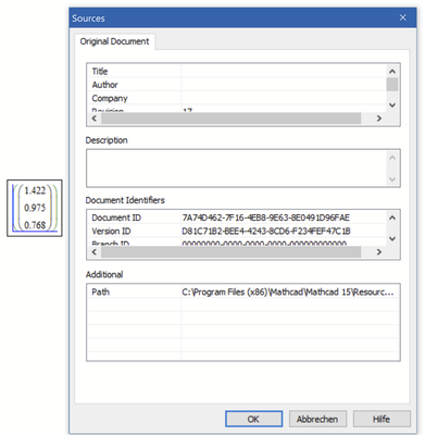

After inserting a numeric value from another mathcad document and highlighting it with the cursor, the inserted number is highlighted with green brackets. What does this highlighting mean and what does this option allow you to do?
(To:DD_13910355)
Obviously you are using Mathcad 14 or 15.
The green parentheses usually just mean that the expression was copied from another sheet (maybe from one of the quicksheets) and was not edited or typed in manually.
Have no idea how this highlighting would be much helpful. You can select the expression and then right click it (can be tricky) to be offered the option "View Sources..."
which will give you some information about the sheet the expression was copied from
I never found use for this feature, though.
Normally the green parentheses only show when you click in a region which was copied. You can shoe them for all expressions which were copied from other sheets via the menu "View"-"Annotations".
You can delete the parentheses or they disappear automatically once you manually edit the expression.

Do the green brackets have to be removed? Could they have some unforeseen effect, such as the value being linked to the document it was copied from?
(To:DD_13910355)
No, no need to do so. They don't have any side effects. Its just information like an annotation. The value is not linked in any way to the original sheet.
You may remove them only if you find them annoying, but they do no harm otherwise.
