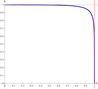

What is the better function for this curve?
ValeryOchkov
The data in attach (Prime 5)!

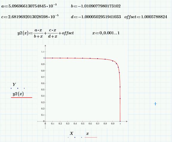

Using zunzun.com it returns this as its best answer:

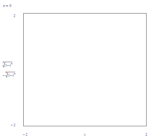

And, of course, no solution without an animation:
Looks kind of like a hyperbola.  See attached in version 6.  (Solving for best parameters would require full Prime)

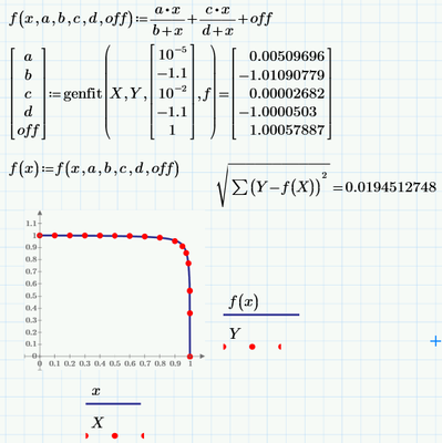

You may create suitable values using "genfit"

my file in 5.0.  zunzun gave me the values, but you could do so with genfit or minerr as WE shows.  Hard part is finding the equation form.  zunzun is slow, but churns through 1000+ equation forms.
