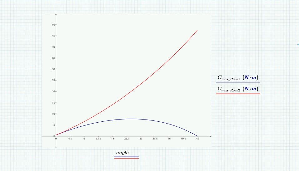

 C is Torque (Couple, in my language, because is Forces x lenght is a couple of values)
the red curve must be negative , because the wheel 1 ( blue curve) climb the ramp
and the wheel 2 ( red curve)  go down the ramp
the force has left the wheel 1 at 22.5deg , even if it continues to climb, the torque decrease.

the file 😏
(To:XDN)
The maximum is not exactly at 22.5°:
Good thing that we have functions 🙂
