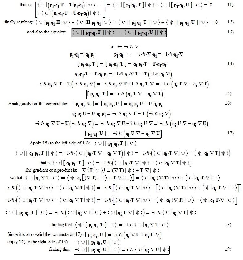

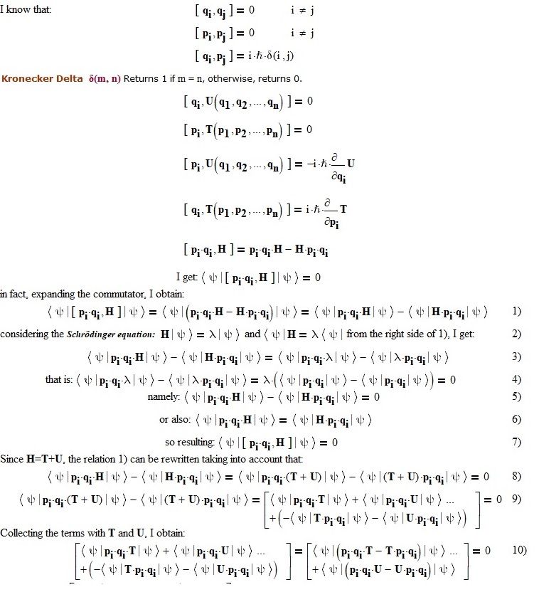

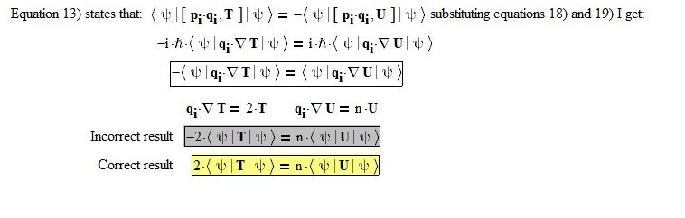

Hi everyone,
I am reconstructing, in a Mathcad 15 worksheet, the proof of a theorem but the result gives me the wrong sign. Can anyone tell me where the mistake is? See photos:
eq 17 - right hand side
1 REPLY 1
