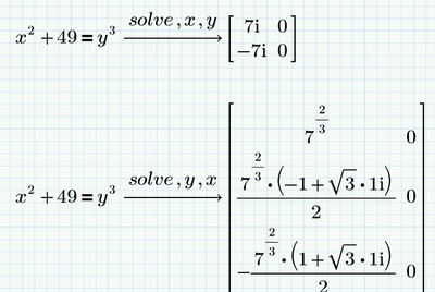

Another example:
LucMeekes
(To:Cornel)
Have you tried using the modifier ALL.  ?
Cornel
(To:LucMeekes)
Cornel
(To:LucMeekes)
Luc, can you try these equations in Mathcad 11 to see what MC11 gives as results?
LucMeekes
(To:Cornel)
Here you go:
If the symbolic result for y comes back as y, it means that you can use any (even complex) value for y.

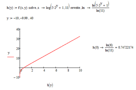

Why lookFor2 is not able to find also the solution x=0.747 and y=0?
Or does lookFor2 only look for positive integer solutions? Then is it possible to adapt this lookFor2 so that it can look also for real and complex solutions?

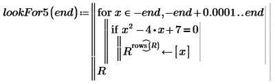

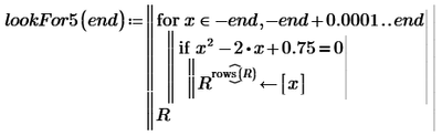

Cornel
(To:Cornel)
@Werner_E
But I see also that this program lookFor has limits. Or?
EDIT1:
And when we can't guess the somewhat exact values, what do we do then?

(To:Cornel)
Yes, it does. Look at the program! There is a for-loop for the x values which runs from 0 to end (=200) with a step width of 1 -> only integer values. Obviously it isn't testing for x=0.747.....
Furthermore y is running starting with the current value of x. So even if x=0.747... would be considered, it woil dnever be tested with y=0.
The program was provided for the one specific equation you had and took advantage of the symmetry in x,y and z in that equation. And yes, it was looking for all-integer solutions only, because otherwise we would get a vector with an infinite number of solutions for which the memory in your computer possibly would not suffice 🙂

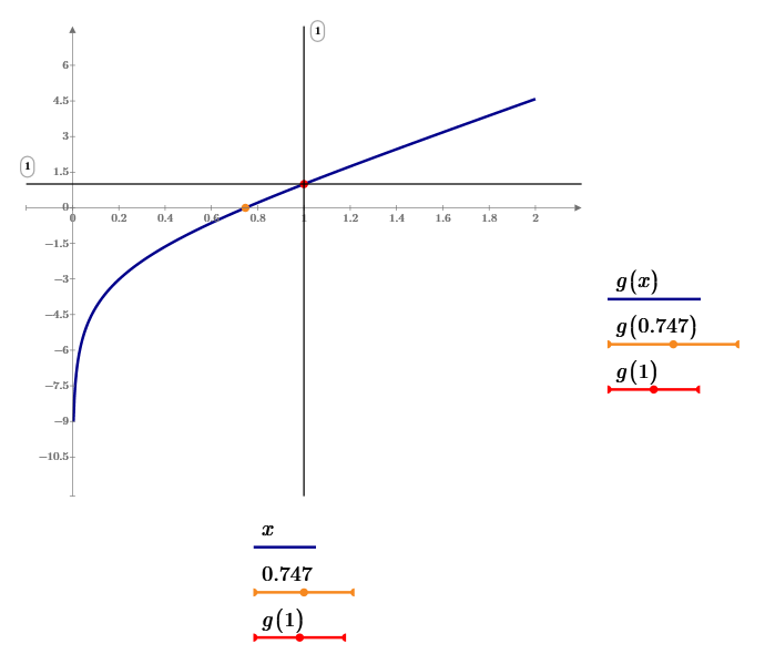

 I will try to say that I wanted to point out.
So, I will show you this with an example:
So, we can see that the solutions: x=1.5 and x=0.5 cut the x axis.
But in the case of:
In this case we cannot see that only one solution cut the x axis, so we cannot conclude that x=1 is the solution for f(x,y).
Here, my question is: how to see and make all solutions to cut the (x,y) axis? Because if the plot does not cut the x axis or (x,y) axis we cannot conclude that the value of x or the value of (x,y) is the solution of that equation.
Also, I am not sure how you got this plot:
