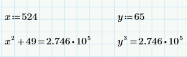

Cornel
(To:Werner_E)
Doesn't it seem strange how the solution x=1 and y=1 is not also displayed on the graph you made?
And when we will have an equation with more than 4 variables, what we will do? because this technique with choosing values for variables I think is limited at 2 or 3 variables, for which we can make 2D plot and 3D plot. And also another problem arises then: what we will do if we cannot rewrite/solve the equation in other remaining variables?

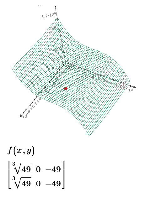

(To:Cornel)
What are you talking about? Just because YOU used wrong scale when editing a picture(!) you think the plot is wrong?
Why don't you plot it yourself and possibly zoom in to have a closer look.

(To:Werner_E)
 I will try to say that I wanted to point out.
So, I will show you this with an example:
So, we can see that the solutions: x=1.5 and x=0.5 cut the x axis.
But in the case of:
In this case we cannot see that only one solution cut the x axis, so we cannot conclude that x=1 is the solution for f(x,y).
Here, my question is: how to see and make all solutions to cut the (x,y) axis? Because if the plot does not cut the x axis or (x,y) axis we cannot conclude that the value of x or the value of (x,y) is the solution of that equation.
Also, I am not sure how you got this plot:
