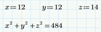

Is it possible for example to restrict in Mathcad 11 the solutions for the first equation: x^2+y^2+z^2=484 at (x,y,z) only to integer numbers? In this case we should see all the triplet solutions of this equation

So in total the first rows results in 6, the second in 48=2^3*3! and the third in 24 solution triples, making up for a total of 78 solution triples with all integer values.
Of course you may also have Prime find them all
And here is the plot of the sphere with the points with all-integer coordinates

Yes, it does. Look at the program! There is a for-loop for the x values which runs from 0 to end (=200) with a step width of 1 -> only integer values. Obviously it isn't testing for x=0.747.....
Furthermore y is running starting with the current value of x. So even if x=0.747... would be considered, it woil dnever be tested with y=0.
The program was provided for the one specific equation you had and took advantage of the symmetry in x,y and z in that equation. And yes, it was looking for all-integer solutions only, because otherwise we would get a vector with an infinite number of solutions for which the memory in your computer possibly would not suffice 🙂
