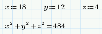

Why Mathcad does not want to show all solutions of an equation?
Cornel
But also we can see that if:
Why Mathcad (at least Prime 8 ) does not want to show all solutions of an equation?

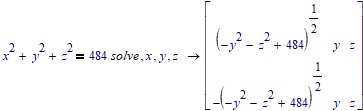

Another example:
LucMeekes
(To:Cornel)
Have you tried using the modifier ALL.  ?

LucMeekes
(To:Cornel)
Here you go:
If the symbolic result for y comes back as y, it means that you can use any (even complex) value for y.

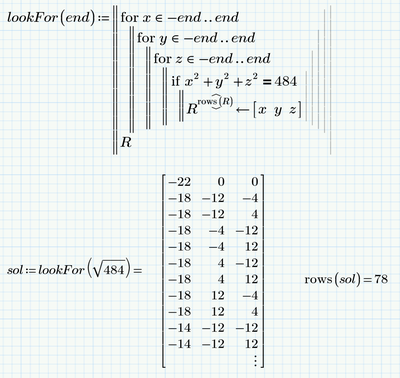

ttokoro
(To:Cornel)
image.pngWe also have imaginary answers.
Cornel
(To:ttokoro)
But how you got these results? Can you upload a Mathcad file or some images with the entire solution?

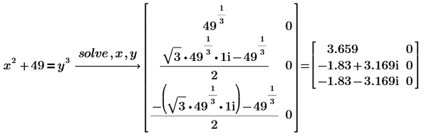

Another example:
Cornel
(To:Cornel)
@ttokoro @LucMeekes
Another example:
EDIT:
Mathcad found wrong solutions:
(To:Cornel)
EDIT:
Correct observation! In the meantime you should know that Prime and especially the symbolics is buggy and not very capable.
Ib this case Prime had mixed up the two columns in the solution. The first column actually are the y-values and the second column (all zero) are the x-values.
Its quite obvious the Prime had solved for y with x=0 as otherwise you would not expect three but only two solutions!
Maybe brute-force?
As we have all squares every value could as well be negative, too,.
Furthermore the values are exchangeable because the equation is symmetrical in x, y and z.
So in total the first rows results in 6, the second in 48=2^3*3! and the third in 24 solution triples, making up for a total of 78 solution triples with all integer values.
Of course you may also have Prime find them all
And here is the plot of the sphere with the points with all-integer coordinates

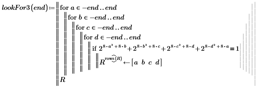

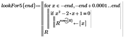

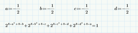

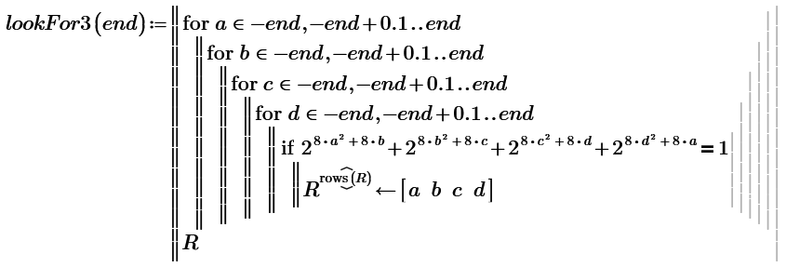

Cornel
(To:Cornel)
@Werner_E
But I see also that this program lookFor has limits. Or?
EDIT1:
And when we can't guess the somewhat exact values, what do we do then?

(To:Cornel)
@Cornel wrote:
@Werner_E
SURPRISE!!
(To:Cornel)
@Cornel wrote:
Why lookFor2 is not able to find also the solution x=0.747 and y=0?
Or does lookFor2 only look for positive integer solutions?
Yes, it does. Look at the program! There is a for-loop for the x values which runs from 0 to end (=200) with a step width of 1 -> only integer values. Obviously it isn't testing for x=0.747.....
Furthermore y is running starting with the current value of x. So even if x=0.747... would be considered, it woil dnever be tested with y=0.
The program was provided for the one specific equation you had and took advantage of the symmetry in x,y and z in that equation. And yes, it was looking for all-integer solutions only, because otherwise we would get a vector with an infinite number of solutions for which the memory in your computer possibly would not suffice 🙂
@Cornel wrote:
Is it possible to adapt this lookFor2 so that it can look also real and complex solutions?
Seriously? Its a brute force attack! It tries ALL (integer) values within a certain interval.
You want to do the same with real and complex numbers?
Trying with ALL real numbers within an interval???? Are you aware that there is an infinite number of reals within every interval, no matter how small?? And how would you like to define an interval for complex numbers???
And then - finding the infinite number of  solutions to your equation would take an infinite amount of time. Unfortunately my time is limited.
Furthermore storing most reals would require storing an infinite number of decimals requiring an infinite amount of memory for just one number. You have to solve this problem first before you go any further!

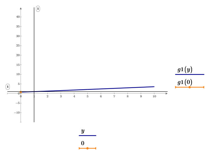

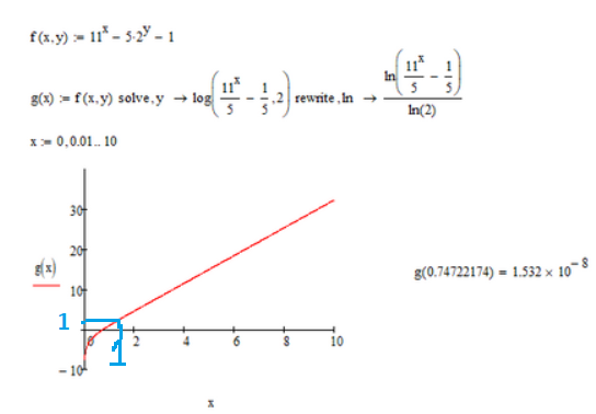

Cornel
(To:Werner_E)
Doesn't it seem strange how the solution x=1 and y=1 is not also displayed on the graph you made?
And when we will have an equation with more than 4 variables, what we will do? because this technique with choosing values for variables I think is limited at 2 or 3 variables, for which we can make 2D plot and 3D plot. And also another problem arises then: what we will do if we cannot rewrite/solve the equation in other remaining variables?

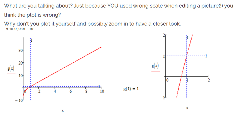

(To:Cornel)
What are you talking about? Just because YOU used wrong scale when editing a picture(!) you think the plot is wrong?
Why don't you plot it yourself and possibly zoom in to have a closer look.

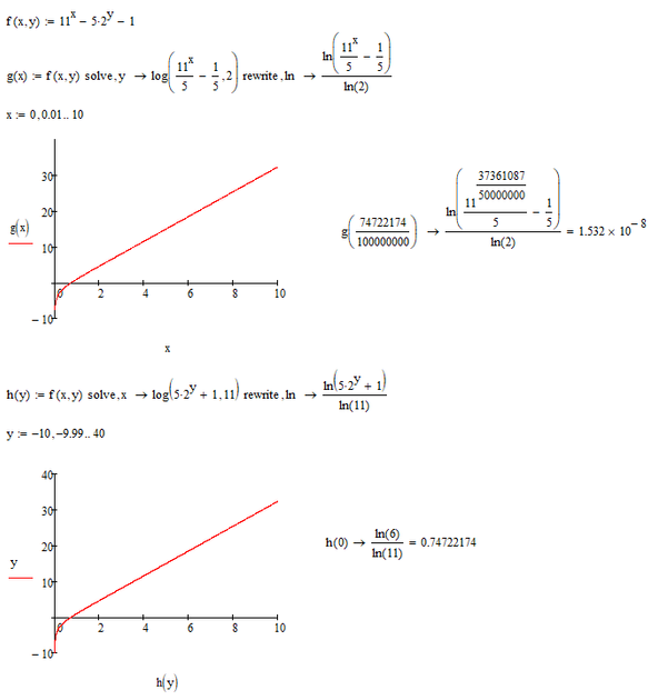

Cornel
(To:Werner_E)
 I will try to say that I wanted to point out.
So, I will show you this with an example:
So, we can see that the solutions: x=1.5 and x=0.5 cut the x axis.
But in the case of:
In this case we cannot see that only one solution cut the x axis, so we cannot conclude that x=1 is the solution for f(x,y).
Here, my question is: how to see and make all solutions to cut the (x,y) axis? Because if the plot does not cut the x axis or (x,y) axis we cannot conclude that the value of x or the value of (x,y) is the solution of that equation.
Also, I am not sure how you got this plot:
