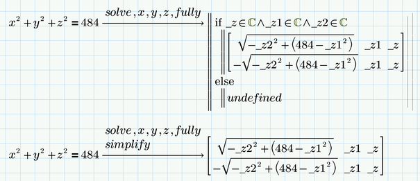

The modifier you may be looking for is "fully"
As you can see the new (since Prime 6) symbolics is pretty faulty as _z2 and _z should be the very same!!
The older symbolic (which is still available in Prime 6 ) is a bit better
It means that you can freely chose y (=_z1) and z (=_z) and you get two valid solutions for x.

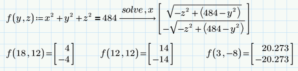

Of course this is the very same you could get with

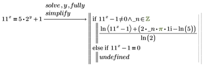

You second equation is too much for Prime
but you may use
which seems to give you for any value x an infinite number of (usually non-real) solutions for y, depending on the chosen value of _n.
