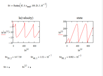

Why doesn't this array display?
JohnRudnicki

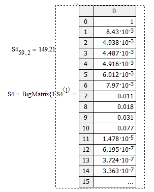

Opened the file in Mathcad 15 and the arrays do display (needed to rearrange and separate the regions):
As you also have troubles with the 2D-plots it looks like a broken installation.
Are you able to display other arrays? Can you display a small matrix which normally would display as matrix in table view?
Have you tried to install Mathcad on a fresh new system (e.g. in a virtual machine). Don't forget about the preliminaries which Luc already posted in the other thread of yours.
I don't really think that it will help, but I resaved the file (MC11 format) and attached it here. Just give it a try.
P.S.: I just noticed that the values blow the plots and above the tables are different compared to your screenshot!? Probably you had changed some input values before posting the file.

Hi Werner,
Thanks for taking a look.
I tried a small array as you suggest. It displayed in matrix format but not as a table. It does seem that I have a faulty installation.  I did successfully re-install MC 14 on Windows 10 a while ago when I had to replace my computer. Not sure what went wrong this time but I will try re-installing again taking account of Luc's suggestions.
I tried the MC 11 version that you re-saved but got the same result.
Not sure about the slightly different values. I  do not remember changing anything but I could have. When I run the MC 11 worksheet you sent, I get the same values as in the screenshot (and in MC 14). Could MC 15 be giving  slightly different results?

Re: Slight difference in values. I looked at this more carefully and, yes, I must have changed a parameter slightly after taking the screen shot and attaching the worksheet - as you expected.
FYI: I am not sure how, but I do have a running version of MC14 although I have been unable to install M020. I will wait until next week when our computer tech guy gets back and see if he can help with installation.
Thanks for your help and best wishes for a Happy New Year!
@JohnRudnicki wrote:
Just some additional images to Werner's:
Worksheet before S4 evaluation is complete:
S4 brought to the front:
S4 evaluation dragged down a few lines:
S4 display changed from Automatic to Matrix:
Stuart
