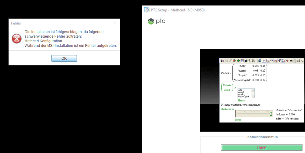

Today I tried to install MC 15 on my WIN 11 or WIN 10 PC and got this error:

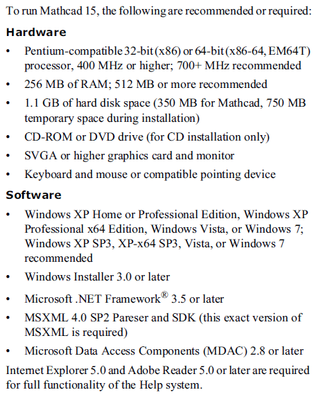

Is that the first time you (try to) install Mcad 15 on that PC?
Did you check that all prerequisites for the installation are existent on that machine?
Next problem may be activation, since PTC has discontinued sales AND support of Mathcad (1 thorugh 15), and Prime (1 through 6).
Read here: https://community.ptc.com/t5/Mathcad-Tips/Official-PTC-Mathcad-15-and-Prime-1-6-End-of-Sale-Announcement/ta-p/818870
