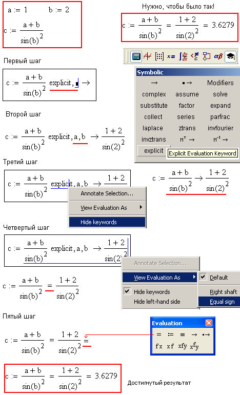

The professor ask to write the equation and the values. Is it possible it Mathcad?
for example I want to write a+b=2+3= and get the answer a+b=2+3=5
Not write:
a:=2 b:=3
a+b=5
4 REPLIES 4
Well, kind of.  There's a symbolic key word, "explicit"  that can do that.  In Prime 3.0 you get
In version 15 you can change the arrow and hide the key words:
Mathcad 15

Thank You for reponses it helped
